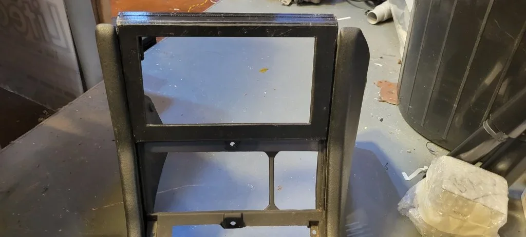

Parcel just arrived including a centre console so I can test out my double-din changes. This is the first test fit of my first rough print. Pretty pleased with it. Got some revisions to do and need to knock up the mountings and surround for the heater controls but so far so good.
