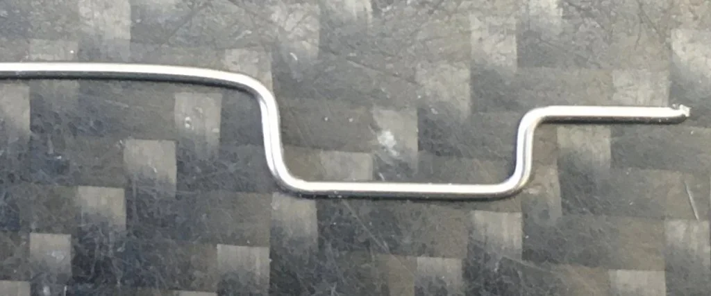

When bending wire, hold it with the pliers and bend with your thumb, gives a much tighter bend. If you hold the wire and bend with the pliers, you get a sloppy bend that can slip out of the locating bracket.
I'll take some pics and show the difference. I should also be able to lend you a pair of proper wire bending pliers if I can find my spare set.

That’s hard stainless wire, bend on the left is holding the wire and bending with pliers. The one on the right is holding the wire with pliers and bending with a thumb. Much tighter bend that doesn’t slip out, I can’t remember what car it was we had loads of problems with. Previous owner replaced a cable badly.
Really needs pliers like these;
