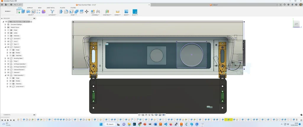

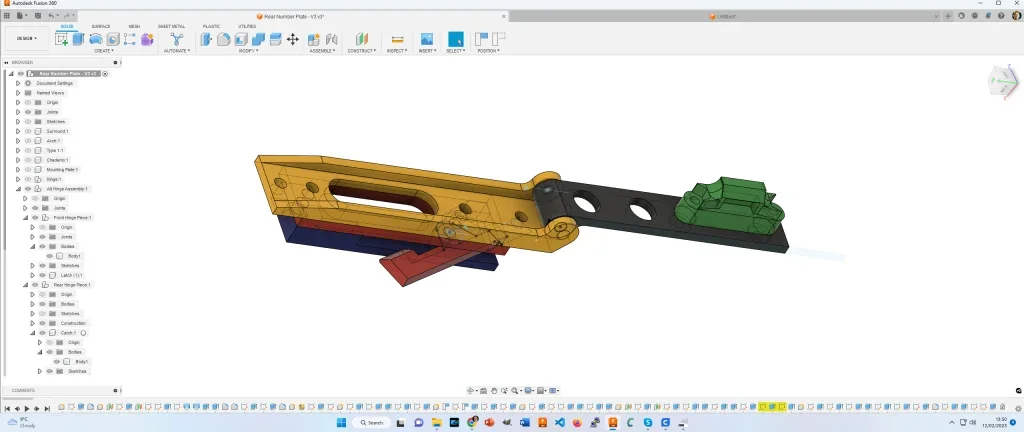

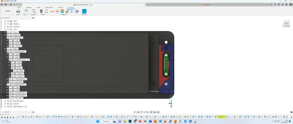

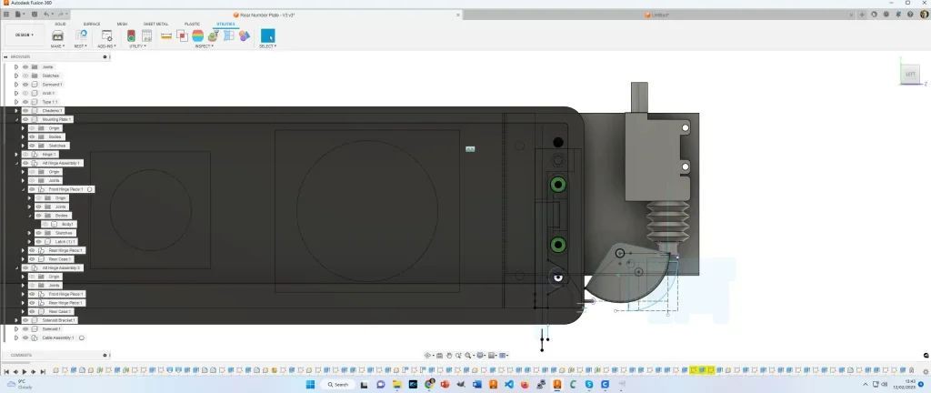

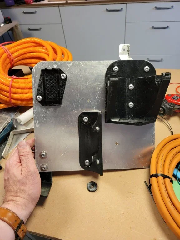

  1. Finish making the hinge mechanism for the rear number plate and mounts for the charge ports that will fit behind it. (Updates on this below)
  2. Print the remaining light buckets
  3. (Possibly) trim/tweak the inner bumper to fit around the outer light buckets (there was a minor clash on the last test)
  4. Adapt the wiring to suit the new setup
  5. Bond & fibreglass everything together
Once I've done all that I can move on to the boot lid, then the front end - lights & number plate. And do a lot of fettling to make everything fit - rear clam and doors currently too tight, per my other post about door adjustments. Then after a bit of reassembly and testing, it can go back in for MOT before going off to paint.
I'm starting with the number plate as it's the most complicated job, and it can be done indoors. It's still bloody miserable out there and I've knackered my back with all the moving, so anything I can do to stay warm and comfortable is a bonus at the moment.

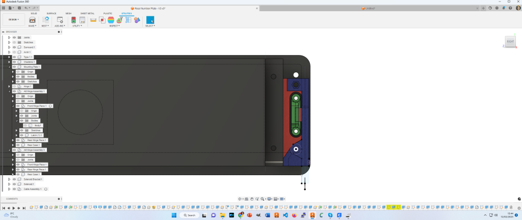

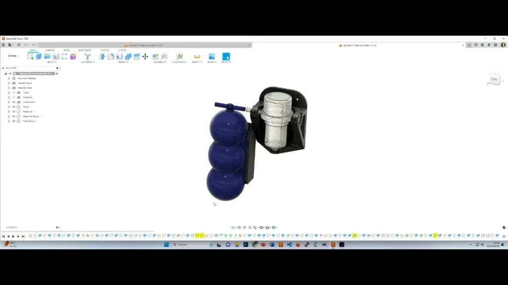

I've been through about three designs so far and I'm pretty happy with the latest one. It's simple, easy to print, and in limited testing so far, seems to work. Not sure how easy it will be to understand from the pics but I'll post a video of all it all working once it's done.
Complicated part is the solenoid as I'm having it pull the cable around a 90 degree bend so that mounting is easier/more compact. But will see how that goes in testing.

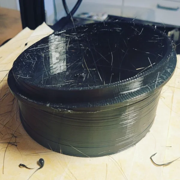

Not too much to report other than that I've managed to print two of the light buckets. But my printer isn't turning out great quality stuff at the moment. Stringy and lots of shifting between layers. Sadly I can't justify a new one at the moment. So I'll have to address this with filler - which it was going to be covered in anyway.

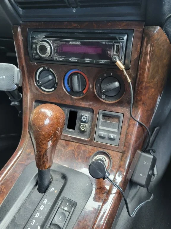

In the meantime, I'm off on a budget snowboarding weekend. Starting with a long drive down to Kent tomorrow in the ICE Z3 (my Japanese import 1.9). So I've done a quick and dirty stereo upgrade to keep me entertained along the way, as the (loosely) fitted business RDS (tape) was failing. This is the Kenwood head unit out of the car I scrapped, with a Bluetooth receiver I had lying around bodged in, and a multi-way splitter tucked away to power everything - including providing 2x3.1A 5v outputs for the phone and the Bluetooth.
There is half a Parrot system in the wiring back there but I seem to be missing a piece from it so couldn't wire that in for the Bluetooth. This will do for now.

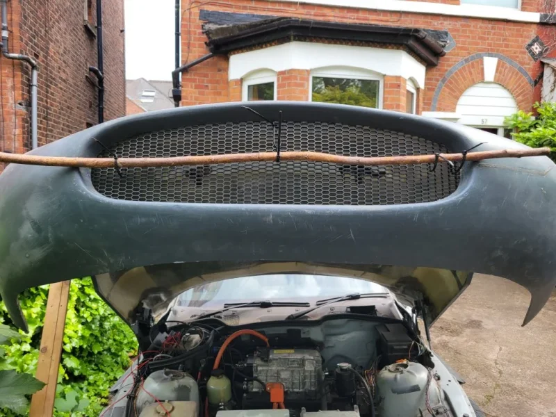

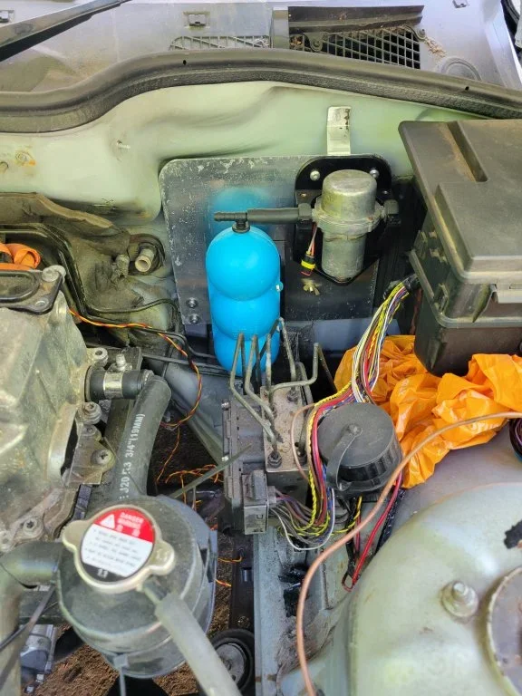

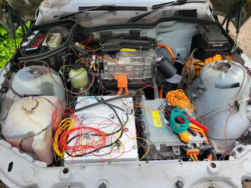

Progress! Eventually I decided to write off getting another garage until I can afford to buy one and instead to bring the car home. With a bit of nice weather I can get it moving again, and into the paint shop.
It has been home for a couple of weeks now and things are moving apace.
  • Headlight buckets are in
  • Grille and front number plate mount are on

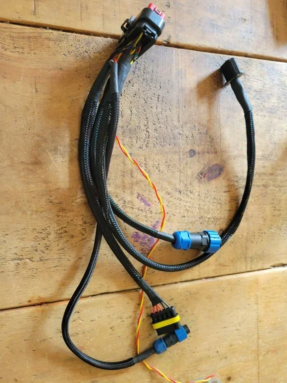

  • Original loom has been stripped back and modified for new lights
  • EV loom has been largely redone, with just battery management and heater wires to go
  • Brake booster arrangement has been redesigned and refitted
Got a little more to do at the front end (fit the headlights, finish wiring, new gas shocks, fix the power steering, fit and wire in the heater - if only to get it out of the house), then the plan is the flip the car around and start on the back end (rear light buckets, number plate surround, charge port, door shuts - currently too tight).
Back to doing two videos a week on the YouTube channel (where work/family permits). Goal is MOT in July, then in for paint/wrap. Might be optimistic - not least as to whether my budget will support that/any paint shop will take it on with the amount of prep required, but we'll see.
Slightly jumbled photos but you get the idea.

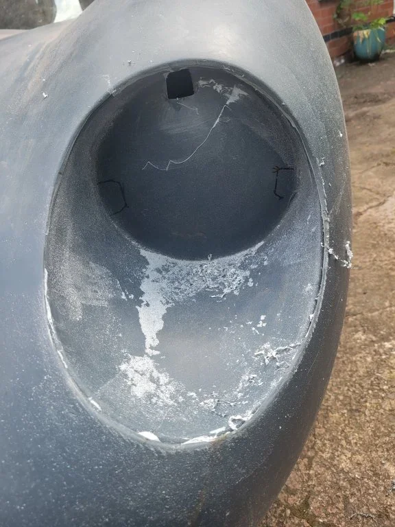

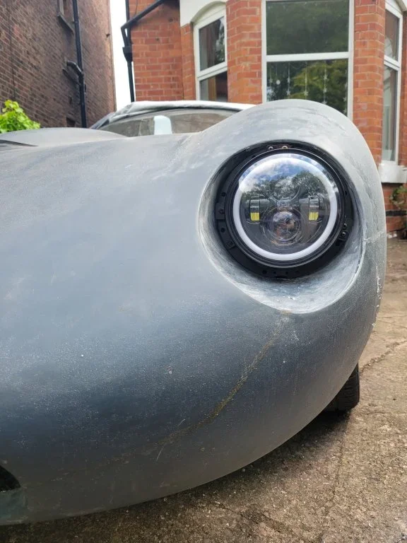

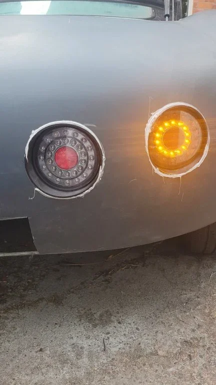

Nonetheless, lots of progress which you will have seen if you're following the YouTube channel or Instagram. 90% of the engine bay rewired. Just got to finish and test the battery management system and PP detect (which turns the car on but disables drive when the charger is plugged in).

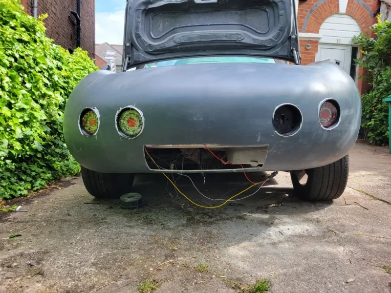

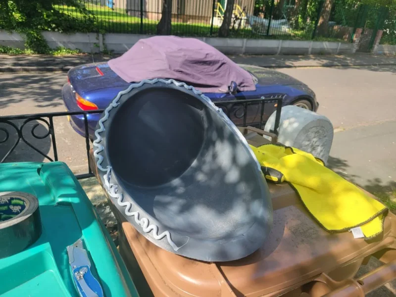

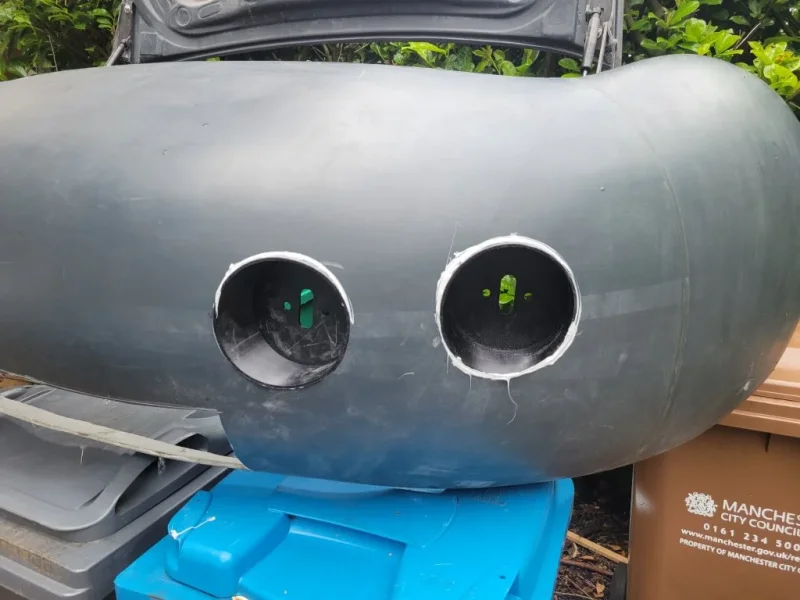

Front lights are in. No covers yet (need to look into those and in the meantime, drill some drain holes). Rear light buckets have gone in today and I'm starting to wire all the lights in.

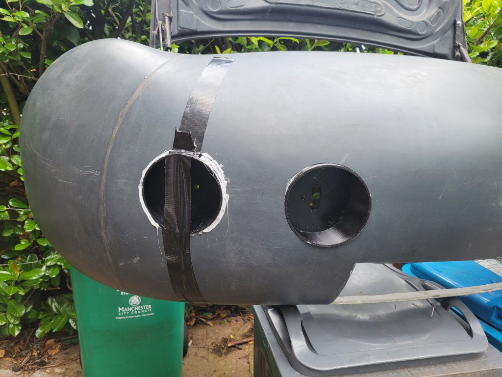

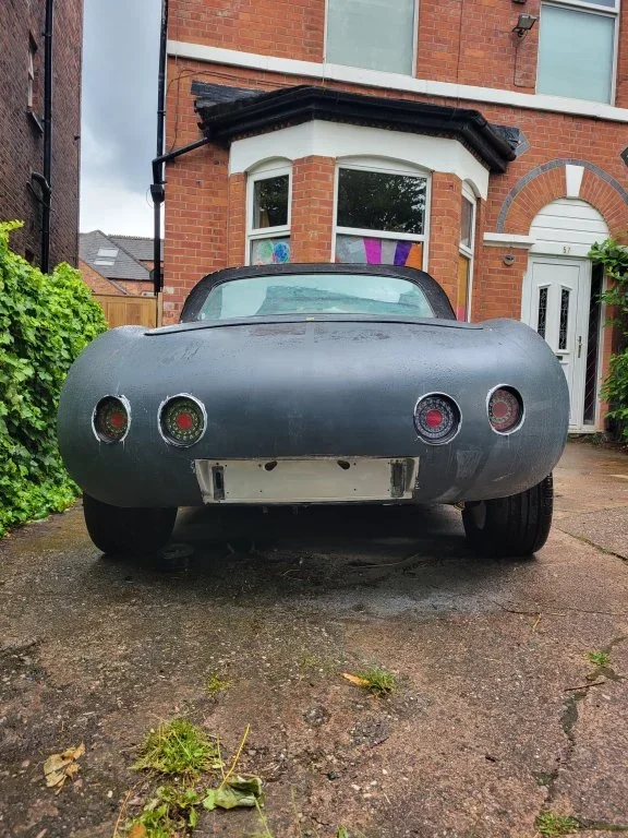

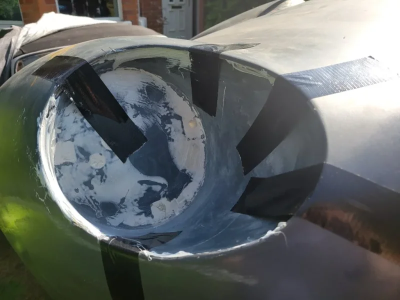

Been busy again today between finishing work and it starting to rain. Trimmed up the cutout and the number plate surround from the old bumper and fibreglassed the two together. Lots of filling and fettling to do, starting with another couple of coats of CSM on the back for strength. But I'm really happy with how it has come out. Exactly like I imagined.
Need some new LED number plate lights now. Anyone know if the Z4 ones fit? I can only find bulbs for the Z3 and one of mine is knackered.
