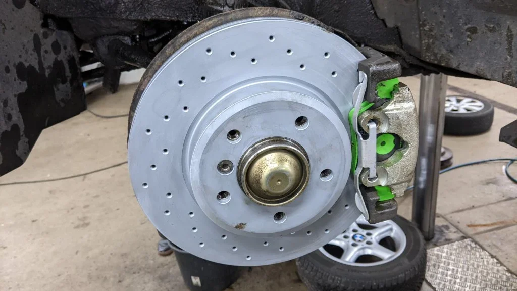

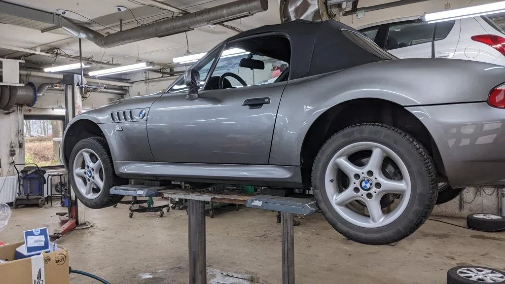

Had a seizing front right calliper that caused big wobbling and vibration for almost 9 monthsx. So it was also an excuse to upgrade my brakes as I plan to hit a couple of track days in the summer. So besides the two new front calipers, I got Zimmermann racing discs with EBC green-stuff and braided steel brake hose lines.
Today got the chance to fit all the parts with the help of cousin 😁

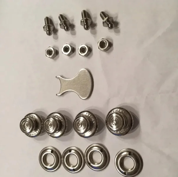

Longer screws for the hood cover:
Waste of time and money (30 squids), as the cover will not clip to them. I've found out that just the two front ones are more than sufficient though.

What’s the problem? I also bought these for mine and agree the price is a bit steep. I think you can buy the other part of the Tenax fastener as spares or definitely from eBay it that’s what’s broken.
Mus Musculus
Nov 27, 2022
114
Ramsey, Huntingdonshire
1.9 M44
Maybe I could buy the part that goes in the cover itself, but how do I fix it? There must be some special tool to add them to the cover, but is it worth considering the front ones work just fine on their own?
Anyway, the problem is that when I pull back the button (?), it just doesn't return to the locking position, hence not locking in place.
The photo is just to show the parts. There are two holes in the front of the fastener, you can use a pair of circlip pliers or similar to unscrew them. The photo shows a dedicated tool.
Check out @AntStark comment about the fasteners on my post https://zroadster.org/threads/tonneau-on-check.53277/#post-746271

Thanks @bombur. I tried to avoid tenax24.de, but I might have to get back to them… I got the cover from someone on this site, but I am not sure I can get (or would want to get ) a refund.
I will think about it though.
Edit: I think that when used stuff is bought, then we have to deal with the issues. I am of the opinion that buyers beware.
