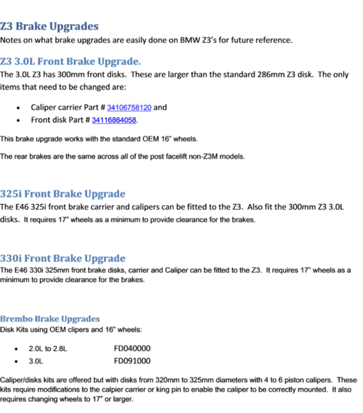

Hi
The attached file are my notes from posts from all around the interweb about Z3 brake upgrades.
As with all upgrades, please check your local laws and automotive rules to see what is allowed and what has to be certified.
Hope it helps.
Regards
Muzz

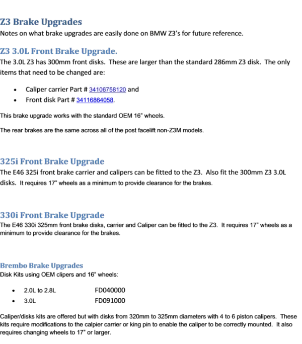

I looked into this a lot some years ago for my M. The only big brake upgrade I found that fitted without modding was the 8 series front callipers they are a 4 pot brembo caliper.
and they look like this. If my memory serves me well they are from an E31. matched with E46 M3 discs
Or you can buy K series
http://www.bigbrakes4u.co.uk/k-spor...-z3-304mm-6-pot-conversion-kit/prod_2238.html
Just buy the discs and your away.
