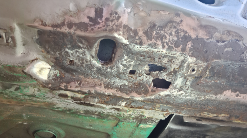

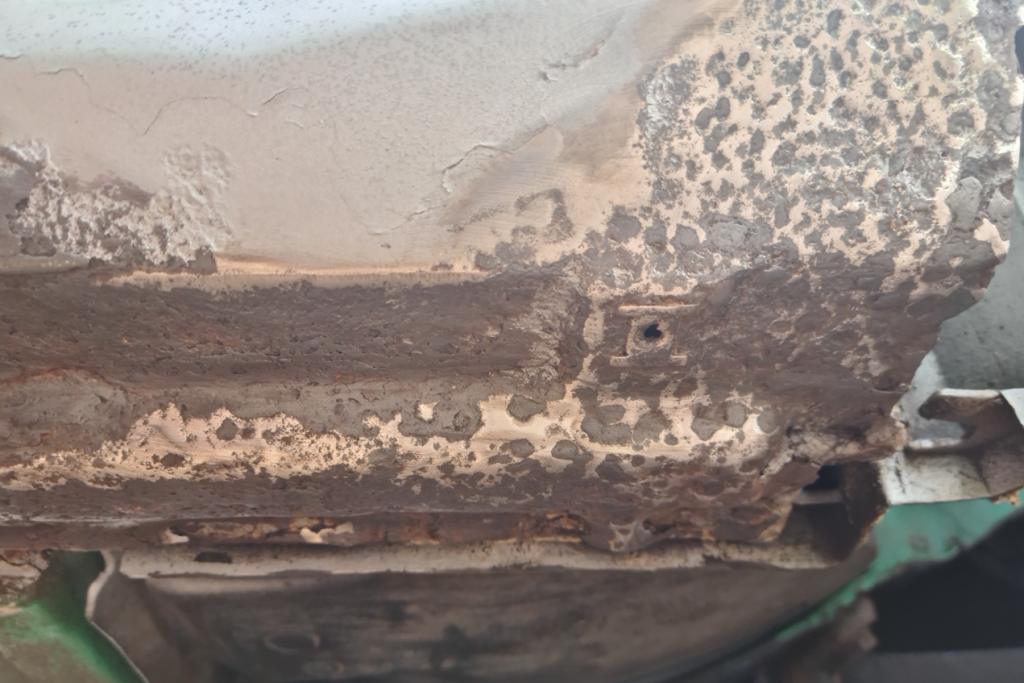

That's more like it mate - much better! All the black stuff that's left is what the Deox will now attack.so that forced me to turn my attention to the sill again... this time I took @DrWong s and @Althulas advice and went right back to bright steel.....I'm actually thinking/hoping ? I might actually save the jacking point and get a patch butt welded in ?... it's the lighting but that definitely shiny (where it's not pitted !)

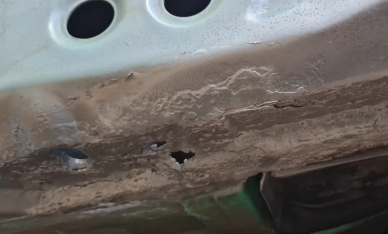

It's worth pulling out the prestal cages that the screws for the outer sills go into, as likely to be rust behind them. They come out dead easy if you can get a hook behind it. It's one of the things that always gets me about the Redish videos, cos they always leave them in.
I didn't take them out the first time I did the sills and rust started spreading from some of them. Did some remedial work a year later and they've been fine since.
