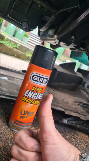

Thinking on the plus side, it stops things from rusting !.... so with my good friends Gunk and brake cleaner I set to work.
subframe and steering rack came up really nicely. Especially those power steering labels !

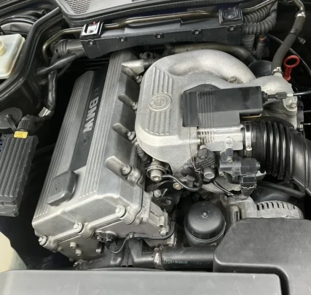

For the engine itself, I have a fair idea what to do about the black cover, but what are your thoughts on the aluminium oxidisation? I thought of going over it with hand held sandpaper but felt a bit extreme ?

My engine looked a lot like yours. I went at it with wire wool and then Autosol polish. It looks like this now.
it’s not going to win any concours prizes but I’m not embarrassed to open the bonnet.
Thanks. If you go this route be mindful of the ferrous dust it creates. I’d recommend wearing gloves and regular vac’ing of the metal dust - especially around the open framed alternator.

Or something like this ? Maybe body colour ?
ooooo a Fiji green rocker cover...hmmm
I need to replace the gasket so a good call...
When you do the cam cover gasket, you must also replace the oil pressure O ring at the front of the head - oil goes up the front gallery, into the cam cover and sprays oil down onto the cam. The seal goes hard with age and bleeds off oil pressure.
With the cover off, it's much easier to replace the plastic coolant stub on the back of the head as well. Two future proofing jobs.
thanks Andy, good info!.. the kit I looked at seemed to have loads of O rings in it so I guess that's why
