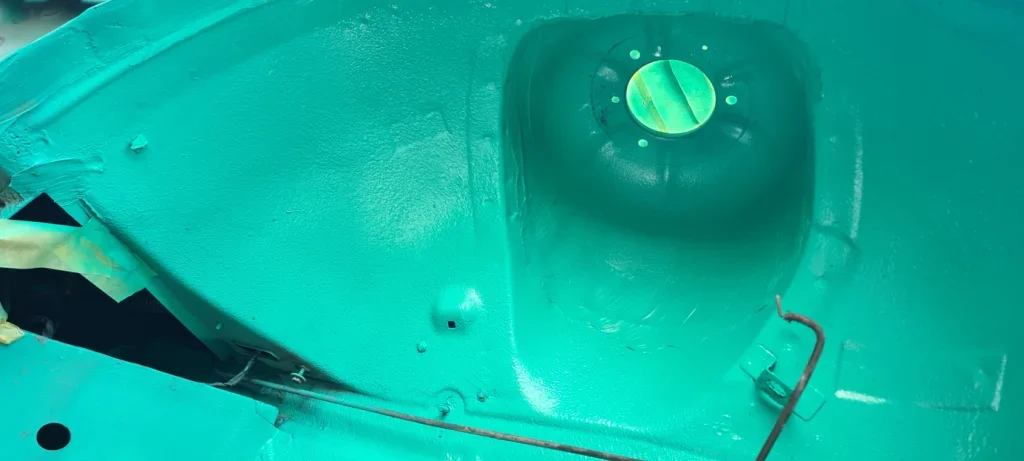

but. for today... decided to clean up and paint the front wheel arches, ready to receive the shiny shocks !
so gave them a decent scrub, firstly with wire pads to get rid of the mud, then warm soapy water, then washed down and then sprayed with brake cleaner as a degreaser... and we get here.

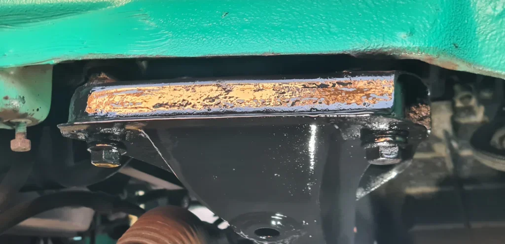

also ground down the front subframe and thankfully no nasty surprises under the grot
liberally coated the whole lot in Kurust...
and let it do it's magic
turned completely black in about 10 minutes
one thing I did notice was an area of crust where the seam sealer meets the lollipops, on both sides, so that needed some attention

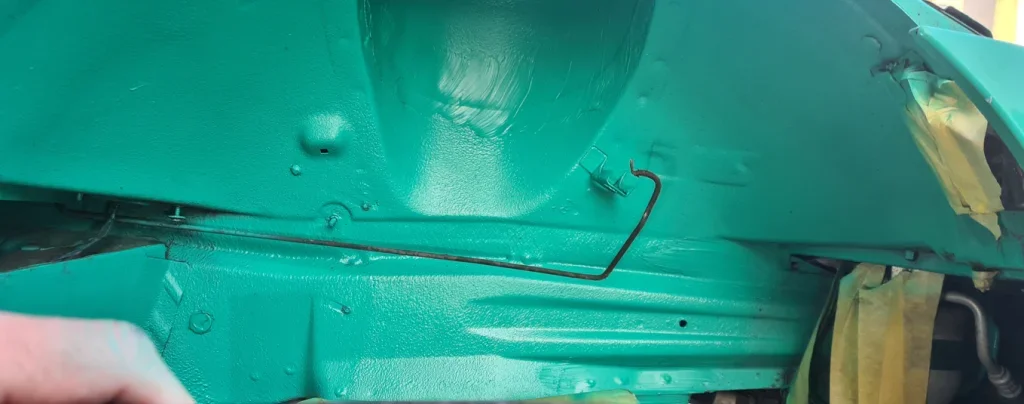

then it was a general mask up, and on with my favourite paint !!.... I didn't go too precise as most of that will be covered by wheel arch liner anyway.

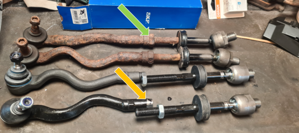

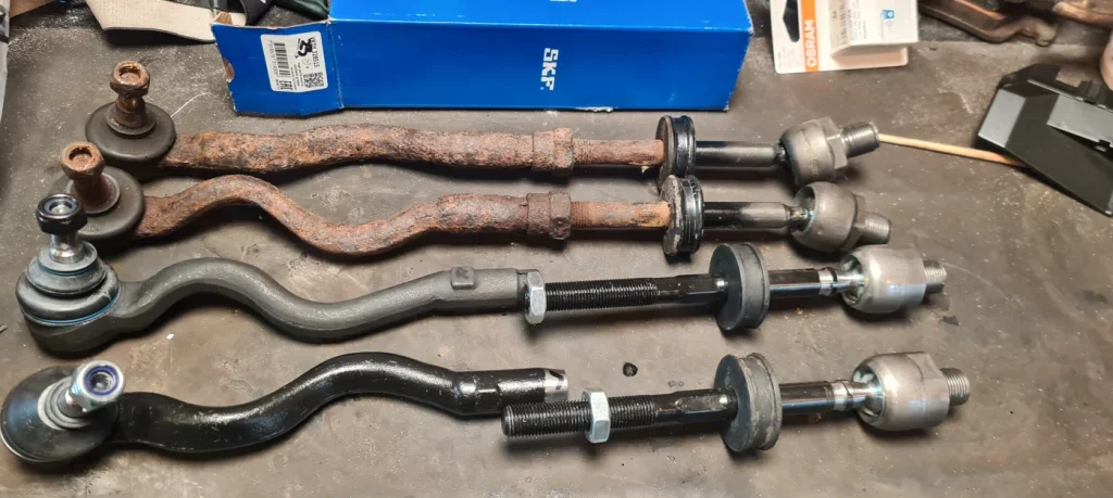

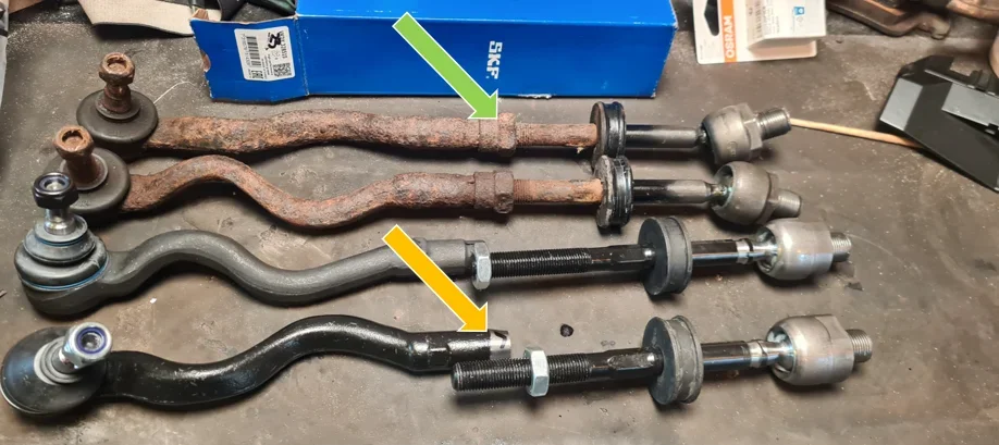

whe I got them on the bench I noticed something that clearly isn't right..
The new outer tie rods have a conical slit, expecting a compression fitting (yellow arrow) and the old Inner tie rods do seem to have like a compression fitting (green arrow)
The new Inner Tie rods though come with just a nut (blue arrow). Not sure yet if you can get that compression fitting separately or I need to get different Tie Rods?

That’s a disappointment, can you send them back?
bought them a couple of years back so doubtful. I never even realised until I compared them against the old ones. I might try and find the "compression" nuts somewhere. If not, it's finding compatible outer tie rods
Not many people have the heat required to undo the tie rods, but if you have an angle grinder (w/ cutting disc), you can cut the rod through the nut, and use one of the old compression rings.
thank you @Pingu .. re using it did cross my mind, but I wasn't sure if it was classed as a "consumable" that you're supposed to replace. If I do get it off I've got to stop myself zinc plating it 😄
Compression rings available on ebay.

The tie rod "clamps" turned up..... I'm still not sure why BMW chose to do this way but hey... ready to go back on....
The next thing I decided to look at was the pesky offside front brake pipe.... it's a pretty convoluted route so might use the option as some have done by cutting it within the wheel arch and adding a union....I'd prefer to replace but...when you see the route !!

Try doing that brake pipe on a 6 cylinder car.
I use a hand held pipe cutter and a hand held Draper flaring tool and join it behind the arch liner.
