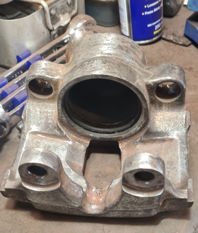

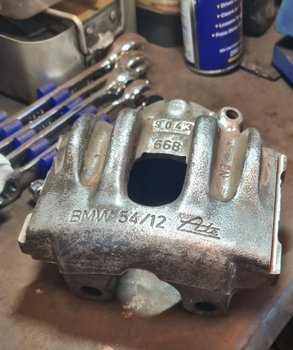

Focus today was on front Calipers.... so it was lots... and lots.... and lots... of grinding rust and other detritus off the surfaces.
used a wire pipe brush for the piston bore and the slider and bolt holes...

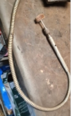

although it worked well, it was a little too rigid, so I then dug out my drill flexi attachment.. but, screwed it into the pillar drill instead of a hand drill, this enabled me to have both hands free..
If you use barrel sanders on a Dremel, one little tip I can offer is, don't push the sanding tube all the way down on the rubber barrel. Leave it slightly overlapping and that way, the top of the sander is more flexible and can get into more nooks and crannies..
