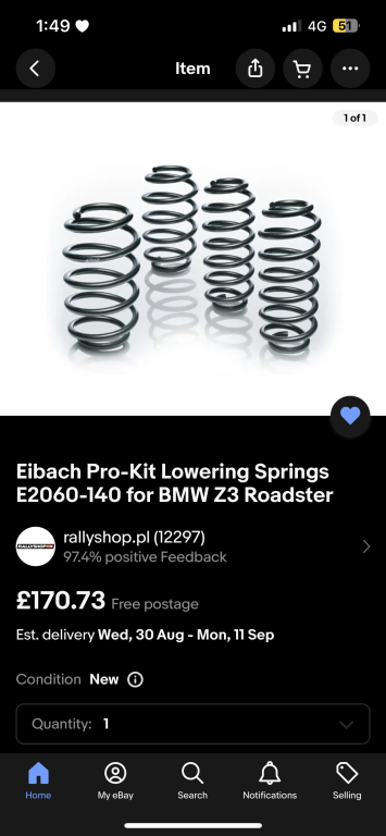

Ive seen these springs on eBay so I may just purchase these for now and not replace the coilovers just yet.
These should give me the same ride heigh I currently have and I suppose there reasonably good springs?

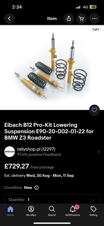

Oh these the bilstein ones you mentioned? @Ianmc
Looks like it, with B8 shocks. Think they lowered slightly less than the 30mm mentioned, but think the stance is just right. Worth the investment if you can stretch to it! :thumbsup:
Feb 18, 2016
Z3M Imola and Z4 (e89)
Any reviews/opinions on these?
I put the B12 kit on my e89, great setup, didn't ruin the ride but improved the handling no end.

think im just gonna get the springs for now to get her back on the road but these will be a future upgrade for sure.
