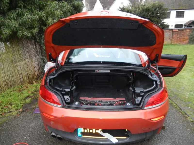

Great news 😁 Boot opened
Thanks to everyone that assisted in this.
I tried everything that was mentioned (apart from emergency release through ski hatch, because UK cars don’t have it).
Only thing that worked is stripping the grey/green cable that is connected to the junction box behind the glove box and giving it 12 voltes. The boot just popped open.
