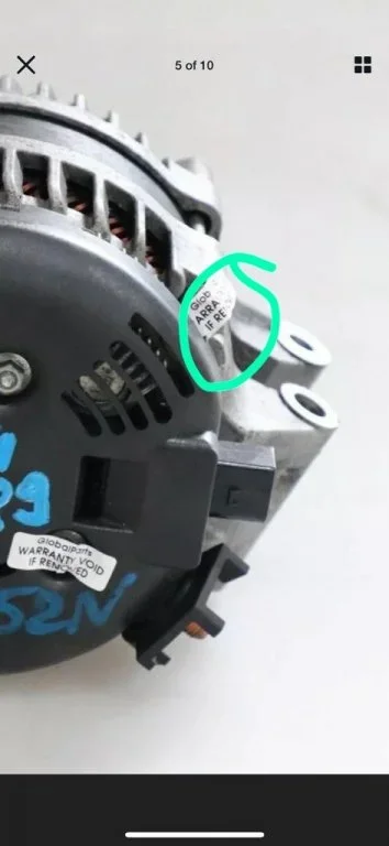

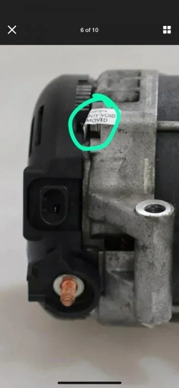

This is the one that I tried is this correct?View attachment 168525View attachment 168525
Cant tell, if its the main from the battery then I don't think so as that's the circuit that needs to be avoided if the positive terminal breaker is activated, battery disconnected (or totally dead) all that will do is try to feed back to the battery same as the jump points under the bonnet, what you need to do is activate the cars electrical system without using the battery supply route. I was told its a nut directly beneath the multi plug (looking from the top) that normally has a plastic cap on it, I am assuming its not the supply to the battery? You are probably in a better position to find it than me tbh, but I am relying on a third party info.

is this what I’m looking for?
Well now I'm confused, they way it was described to me looks like its the main power cable nut that he was talking about, but you said that didn't work?

Yeah that didn’t work.
There are also 3 options from above.
Should you connect to the post with the cable attached?
Should you connect to the post with the cable disconnected?
Should you connect to the disconnected cable?
What do you mean connect to the post?
