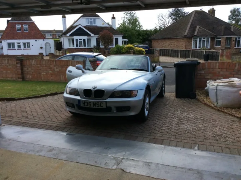

Well the Saga has ended.........
Sorted out the handbrake this morning ( and I will deny that I ever PM’d @t-tony yesterday to get advice on it :whistle::whistle:, and that I put an adjuster on backwards........:banghead:)
So quickly moving on......
Handbrake now fine, no fault codes, engine ran up to temperature and ticking over properly.
No exhaust leaks,
Just needs cleaning now .....( wonder if @andyglym would like a weekend in Butlins??????)
A big THANK YOU to everyone that has helped me through this refurb, (from physically replacing bushes at Zedshed HQ, to words of encouragement from the other side of the globe), as with out all of you, I could never have done this.
I think I can now drop the Novice status.....and move up to Trainee Apprentice :):).....
All this........and now I cant go out in it :bashhead:
