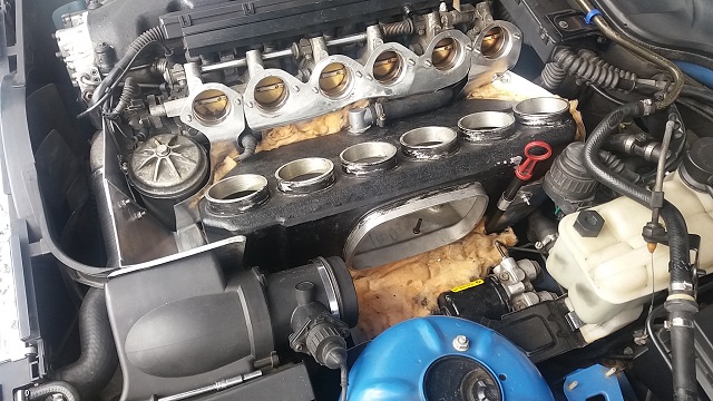

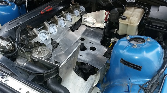

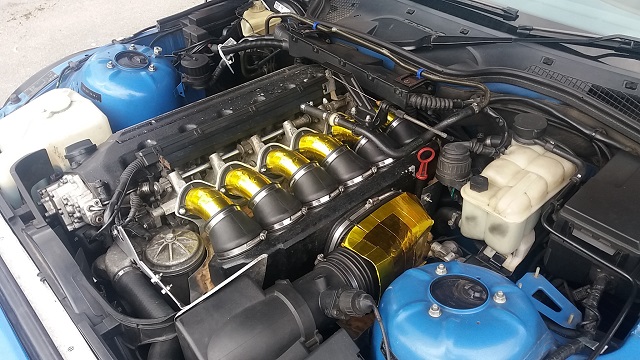

    -----------Summer 2017----------------
    Crankcase ventilation hoses - £31.74
    Aluminium (for intake cooling & shielding) - £21.58
    [​IMG]
    Loft insulation (for intake cooling) - £0
    (I've tested it - and I can't set it on fire!!!)

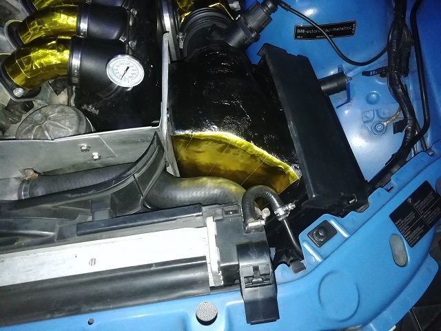

    [​IMG]
    Stainless steel mesh to keep loft insulation in place around MAF-to-Plenum elbow - £4.99
    Gold heat tape (for intake cooling) - £19.58
    (I can't set the gold tape on fire, either!!)
    [​IMG]

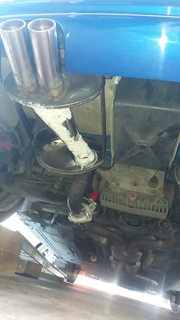

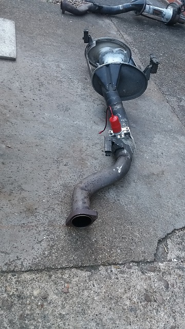

    -----------Winter 2017/2018-----------
    Exhaust modifications...
    Made straight through muffler using 304 Stainless Steel
    [​IMG]
    Rear exhaust section with a bypass valve fitted...
    [​IMG]
    and fitted to the car...
    [​IMG]
    Total cost for the stainless steel tubing, argon gas and stainless welding wire was around £100.

    That's an impressive list of jobs Pingu. Whats the exhaust valve do? Open up that branch of the exhaust? How is the noise?
    I didn't know you had contributed to the Forbes retirement fund :rolleyes: Think your fix should be ok so its a big job to fit for maybe no gain?

    Yes, it works as a town-friendly car with the valve closed and as a monster with the valve open. It's perfectly safe because there is a cross-over pipe.
    The comment from some bikes that I passed was "By 'eck, that's jolly loud. old boy", or something like that - I couldn't hear them properly:whistle:
