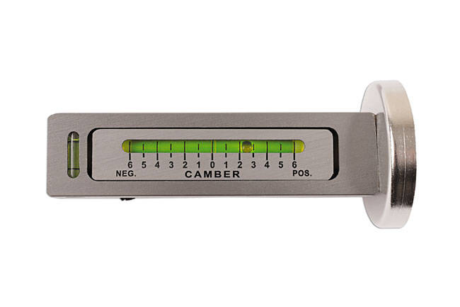

LHR bearing is done. It's not an easy job, as anyone who has done one can tell you.
Tracking is not going well, but camber is close.
Rear camber left = 1° Neg
Rear camber right = 1° Pos
Rear toe left = 26' Out
Rear toe right = 1°00' In
Wheelbase right = 2455mm
Wheelbase left = 2465mm
I think that offset pins for the rear beam bushes will cure most of the problems. I think a 3.6mm offset at each side will bring the wheelbase closer to 2460mm (it should be 2459mm). I just need to work out how I will make it.
Pingu
3rd Party Trader
Dec 8, 2011
145
I can't help reading all this I think that I should be saying Sorry !!
Good news :)
After buying the stuff to make the offset pins, I had another look at the tracking and camber. Camber is much improved and only just out of tolerance. It may come into tolerance when I have weight in the car.
The same with rear tracking. It is the same on both sides, but toed-in a bit too much.
I think everything could sort itself out when the rear end is fully assembled, but it will be much harder to adjust.
Camber Right = 0°
Camber Left = 1° Pos
Toe-in = 1°09'
Deviation = 0°01.5'

It would be interesting to see how accurate your method of measurement is. Nice to see it being done from first principles!

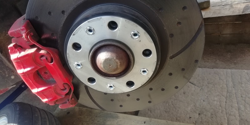

Z3 project
Drill out the threaded hole with a 13.5mm drill and press in an M6 nut...
Job jobbed :cool:
Forgive me, but that looks decidedly dangerous to me. Six tiny contact points on each nut? Just asking to ream themselves free IMO.
Duncodin
Sep 8, 2021
163
Pontrhydyrun - in Crow Valley
M44 FrankenZed
I was thinking that the original thread got stripped because the bolt bottomed out. If that was the case then it'll still bottom out and pull the nut out of it's seat.
I thought those spinners had brackets that went behind the wheel?
