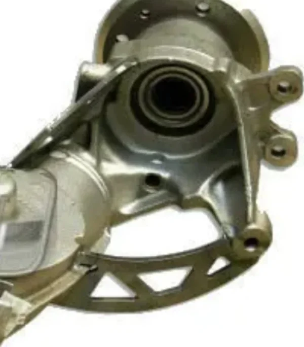

The compact race/drift guys reckon they can bend the rear arms, even the ‘reinforced’ Z3 wide body arms, so they add more bracing between the casting and the pressed arms. Why I did the same to mine. None have mentioned bracing the beam and there are no commercially available components to do so, that I’ve spotted anyway. Loads of arm bracing pieces though.
I did hear a story of someone bending one of the pins holding the arm, nothing confirmed on that. I braced the little bracket, more because it was there and I had the off cuts sitting about, than a belief it will achieve anything.

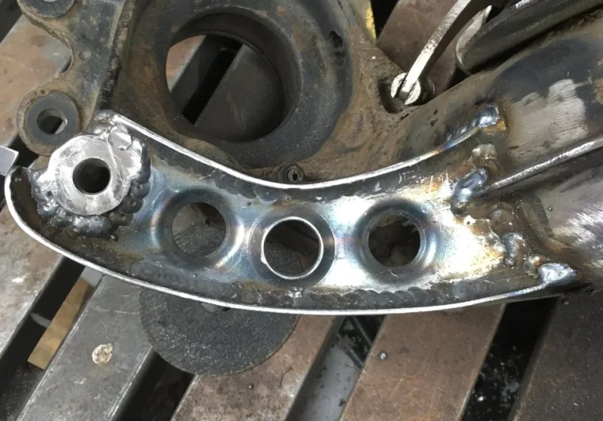

The arm isn't a full casting Pingu, the inner legs are a welded pressing. I'm told it either bends at the end of one of the legs, or where the casting is welded.
I used 3mm steel, cardboard template from the arm to the damper mount. Dimple die'd, strip welded to form an H. Piece of 3mm from the top of the casting to the arm. Don't have my phone on me, can't post pics.

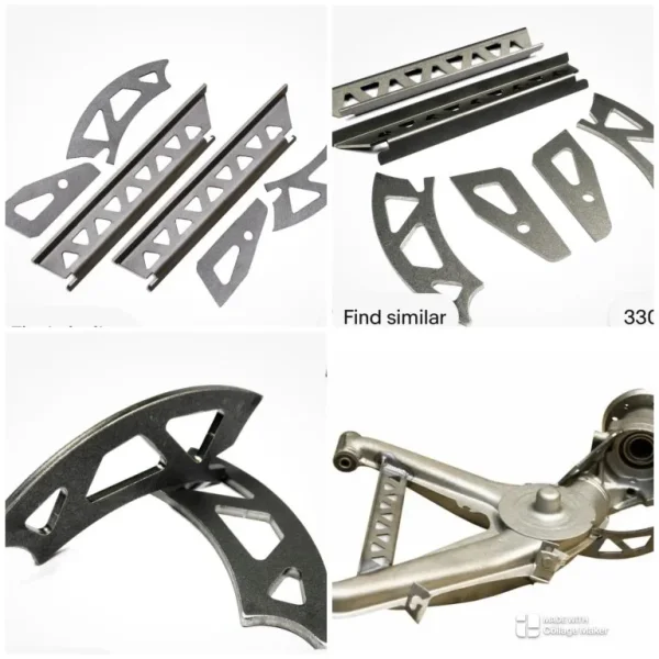

The arms are two 3mm (I think) pressings welded together with a casting welded on the end. The arms are down the just over 2mm where the metal has stretched during forming.
There are lots of these kind of kits on the bay
Depending on who makes them, these are either 3 or 5mm.
I made mine from 3mm topped with strip, fettled them until I had zero gap, then welded them on with a series of hot tacks, immediately zapping with an air line to cool the weld. It’s not pretty, but there’s no chance of distortion.
There’s a piece of 5mm from the top of the casting down to the arm, but I don’t have a pic of that.
