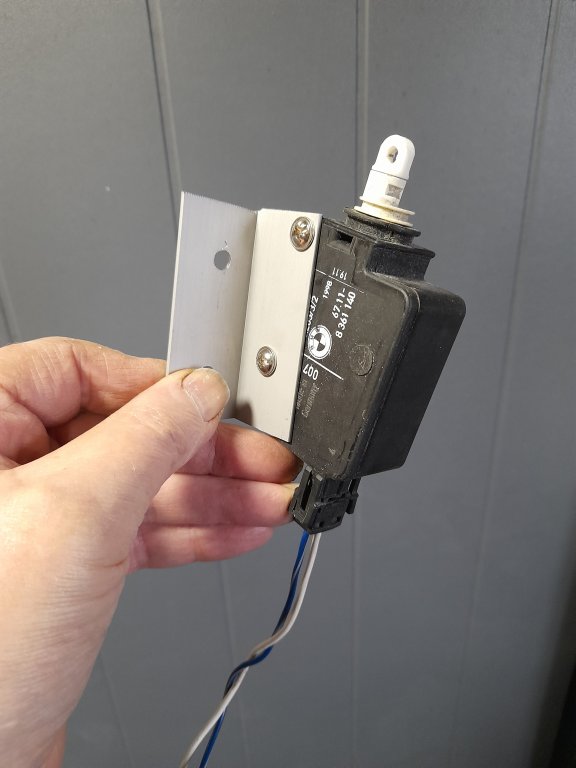

I think motor actuators do have the strength. The ones used in central locking systems as suggested by Tony. Before I go out and buy an actuator I'm looking at the one from the z3 boot lock. It's quite strong, original bmw and not too big/heavy. But it only has around 12mm of travel. It's also bi directional so doesn't have a return spring.

Boot lid actuator. Attached to bracket.

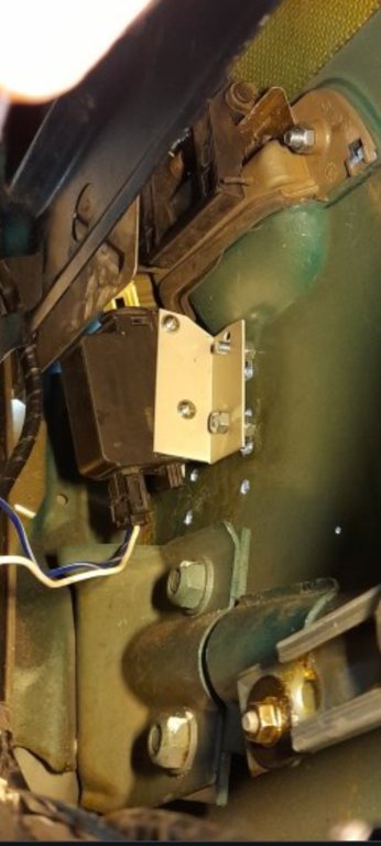

Mounted inside door just below the handle. Bolts through from the outside.
Difficult to know what that picture is but anyone doing a rebody will know what it is.
Actuator pulls on this lever.
The lever is where most builders put their strike plate. Mine has the same effect except mine is pulled not pushed.
The button on the new door handle pushes down on an electric button that powers the actuator. Pulls down on the lever to open the door.
It does work but the actuator occasionally struggles to pull against the return spring in the old handle. I removed the rerturn spring and it works better but now I don't trust that it will always return.
So. Electric pull does work but I think it needs at least a weak return spring to make sure it always returns to the start position.

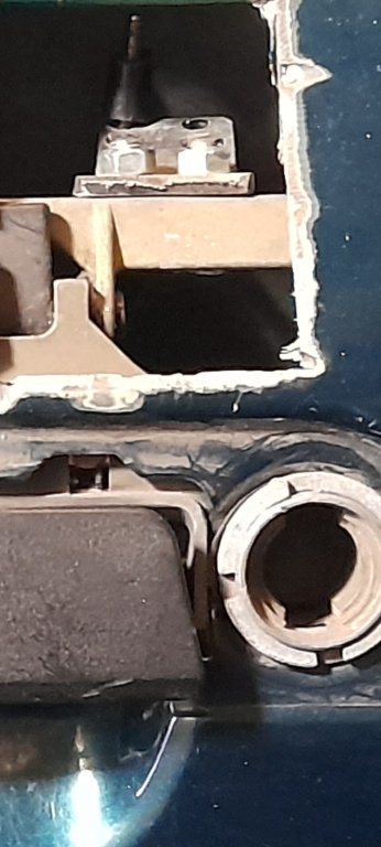

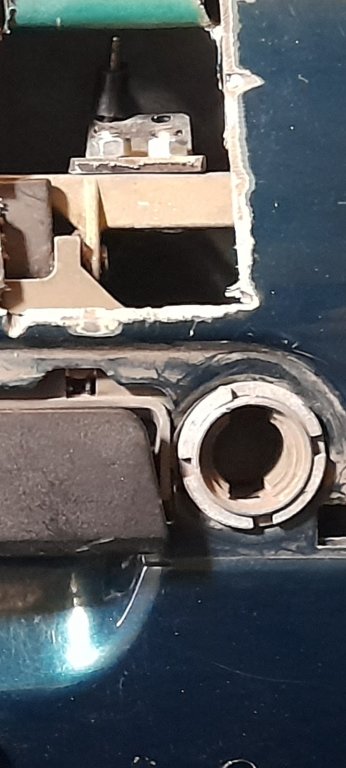

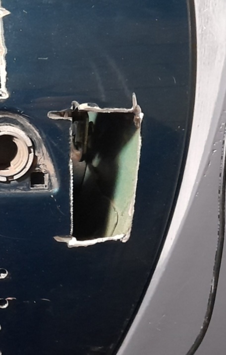

Is there space for the actuator to pull directly on the lock mechanism lever?
Assuming you mean the lever that you can just see through this hole. That was my first plan.
That would've been perfect. But no. Made a big hole. Put in a small solenoid but solenoid didn't have the umph to pull it and not enough room once the skin was on. So didn't bother trying a bigger solenoid or actuator. Pity. I liked the idea.

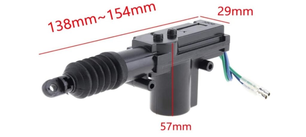

I put a level in the same place as your strike plate and actuator pulls down on that. Was using a boot lock actuator but it only has about 12mm of travel and return spring in the lock only just pulled it back up again so didn't trust it. Deadlock waiting to happen.
So now I'm using this one
It's got about 15 - 16mm of travel, powerful enough to do the business and once the power is off it's easily pulled back up again. Inside the door same pulling down on this

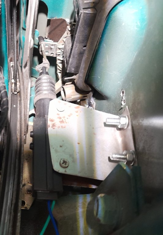

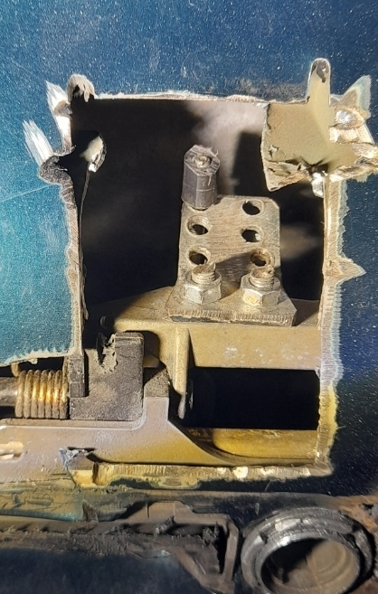

Here's better pictures of the door actuator.
The lever bolted to the door handle. I made multiple holes so I could try connecting the rod in different places. To the bottom left of the hole is the handle return spring. That's been unhooked we don't want that extra resistance. There is a return spring in the door catch itself and that's enough to reliably pull the levers back to the home position.
Looking up inside the door at the actuator with the lever above it.

Actuator is THIS ONE don't use the brackets that are supplied. They're weak.

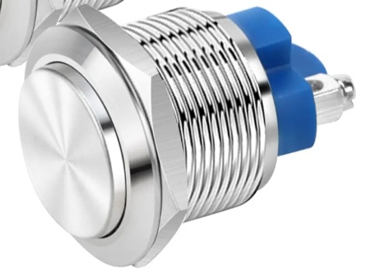

Inside the door behind the handle button/plunger is one of these (22mm metal)
The button triggers ONE OF THESE the fuse on the relay is 30 amp. Way to high. I'll leave that on the relay though and fit a 5 or 7.5amp inline fuse somewhere easy to get at
