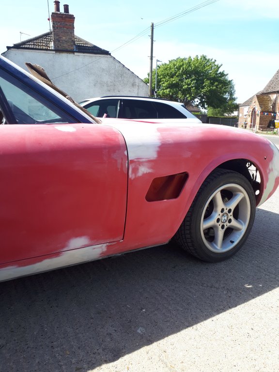

Actually I just wanted to check out the flat spots on the wings. Can't beat a shine for seeing dings.
I didn't fill the flat spot as others have done.
I couldn't help but think the glitch was not actually the flat spots but in highspots either side of the flat - So I sanded the highspots instead. I think it's (almost) OK. I say 'Almost' because there are still a couple of flat bits but I think that's more likely me going at the mould lines. Mould lines on the front wings really were deep.
I will bite the bullet and take it to the body shop eventually. But still have plans to make more body mods. Still not happy with the grill or the bonnet and I'd really like to chop the sides and curl them under rather than the 'slab sided' look that kinda grinds my gears now.
Then, one day, when I can't find anything else to mod I will take it the body shop.

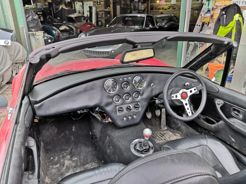

Hi, perhaps speak to Ian @ classic coach works too. He has dash options for the various 250s and zgt and Kobra. A mix and match with various components could work. And he loves a dash and wiring etb dials 😜

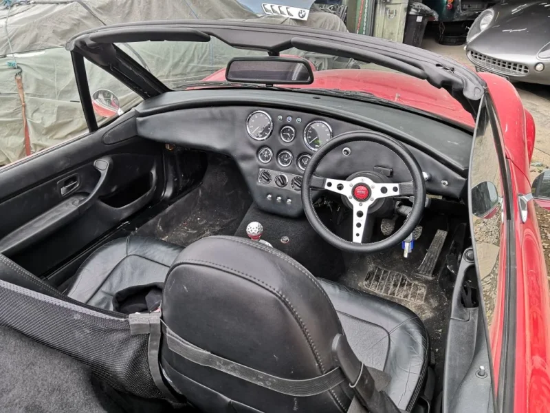

My kobra dash is nice and flat. You could place a binnacle in front of it maybe. I also kept the existing heater controls in place. Please ignore the terrible dash covering. I've never done one before , or ever again.

I like my two tone dash with the extended leather option. No way I could go through the stress of chasing wires all over the place now.
So few people know what the original dash looks like, I don’t have an issue.

Sorry but that picture looks just the interior of a Z3 (cos it is). I know everyone is different but I just don't understand; why go to all the trouble (and expense) of changing a car to look like something else but it looking the same as it started on the inside.
I know it's up to the individual to do whatever they like, but I just don't get it and don't think I ever will.
To my mind this 'changing' a car to 'be' something else has to be all or nothing, or what is the point?
But in the end. They are all Z3s underneath whatever we do to them. Always will be but as long as we understand and accept that then it doesn't matter.
