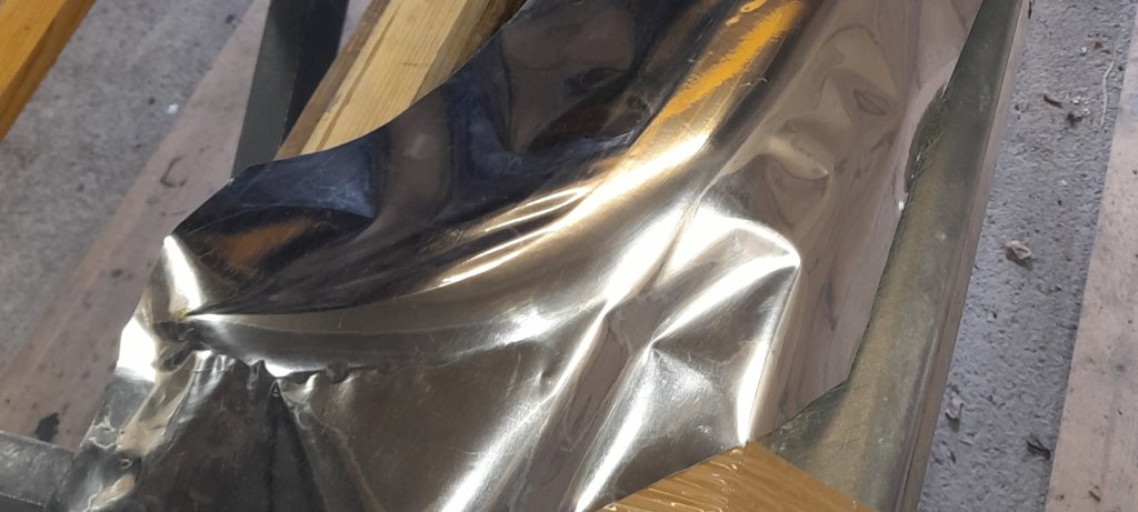

Having a go at wrapping - but as per usual I just go straight in without reading up on how to do it 🤷‍♂️
Turns out there's a thin plastic film over the surface of the sheet that protects the gloss surface during transport/packing. You're supposed to peal it off before trying to use the vinyl otherwise it won't stretch properly. Suffice to say I didn't peal it off. d'oh!
Anyway. The chromy-glossy-ness is good.
Excuse the mucky hand marks
Can't see it in the picture but there's creases all the way along the bottom of the bumper so I can't leave it like that.
(a) Need more practise.
(b) Need to remember to peal off the protective cover
(c) Need more vinyl because I used it all up in the first attempt.
But I think it'll look OK eventually

If you can get the wrap wrinkle-free on a complex structure like a bumper, I will come down to Wales and shake you by the hand (and buy you lots of beer).
Duncodin
Sep 8, 2021
163
Pontrhydyrun - in Crow Valley
M44 FrankenZed
I don't think it's possible to do it in a single piece. Maybe the standard coloured vinyl would stretch enough to do i one piece but the chrome stuff doesn't stretch as much. Maybe an experienced wrapper could do it but I'll never get that experience.
But I do think I can get it with two pieces. One on top side and one on the underside with a join around the front. Maybe a stick on rubber strip to cover the join.
I need to buy more vinyl then try again. Also need a space heater because wrapping chrome in winter is like trying to wrap the sunday roast in tin foil without creasing it.
