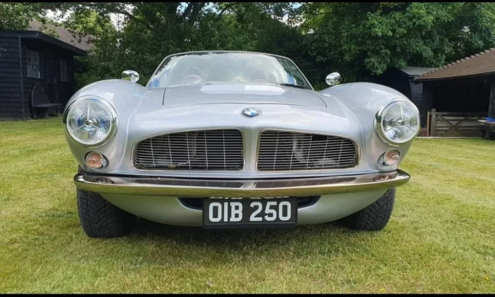

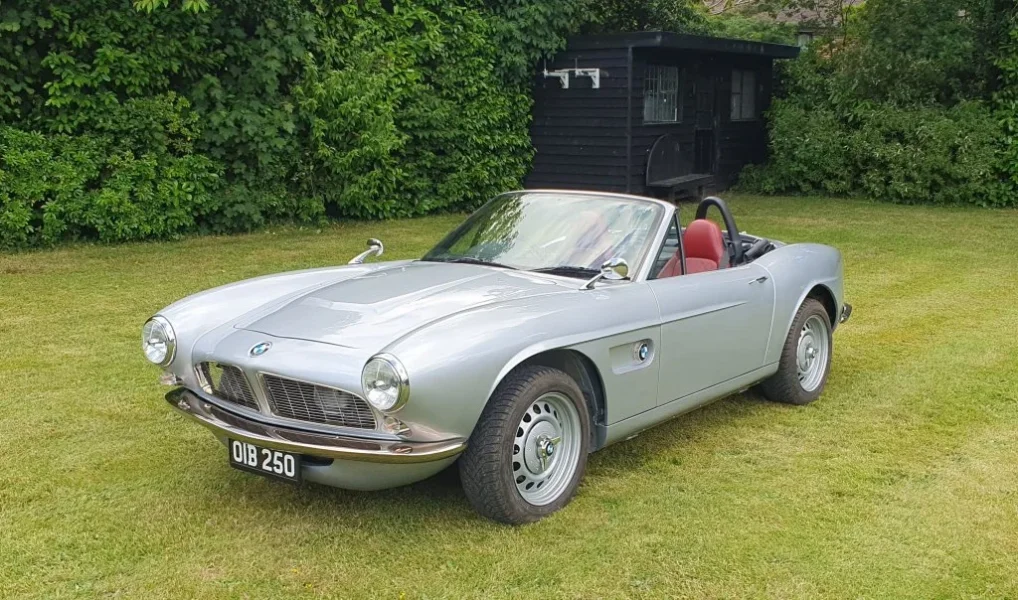

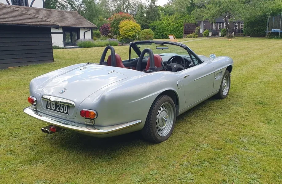

Hardtop on for the winter - I will drive it regularly come rain, hail or shine.
Needs bigger/taller wheels to fill them arches
Bit of uneven gap on the hard top edge. But it'll do for the winter. I'll fix that over next summer.
But I'm starting to think the rear bumper is too big for the car. Needs something a bit daintier m'thinks. Not so sticky outy and less down the sides. Maybe even just corner bits. Something to think about over winter.

That looks flipping wicked. I hope you are as proud as you deserve to be.
Nice build. Colour really suits it.

Looks better in the photo. Not so good in the flesh. Most of the colour is still gelcoat. RAL7015. I had to paint the driver's door because I had to slice off the swage line and stick it back on half an inch higher. Hardtop also painted. Rattle can job. Couple of places where rubbing down the mould lines went all the way through the gelcoat also needed painting. Colour match is OK but not perfect. But I do like the RAL7015 but when i go to paint I may go a shade lighter towards MB Blaugrau
