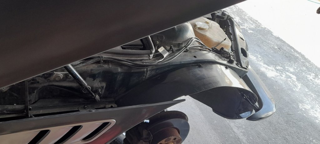

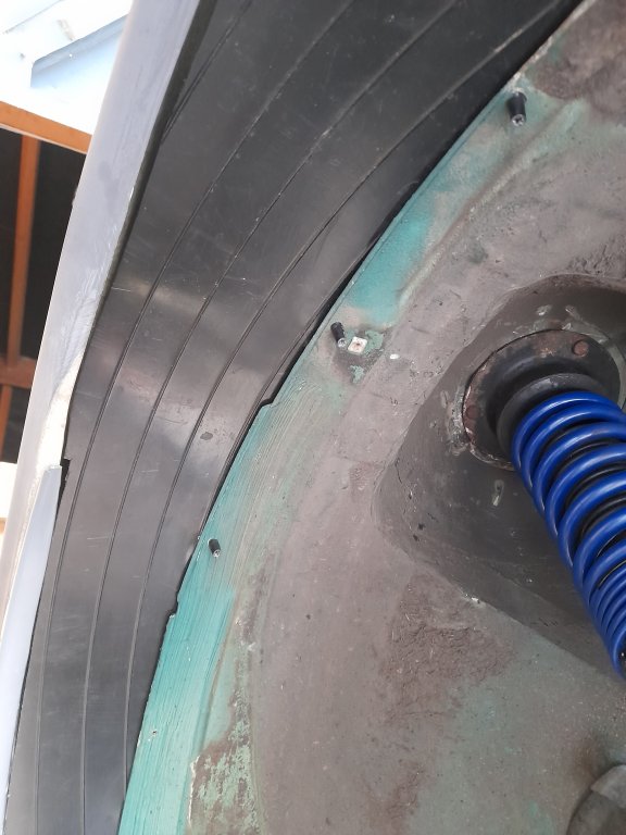

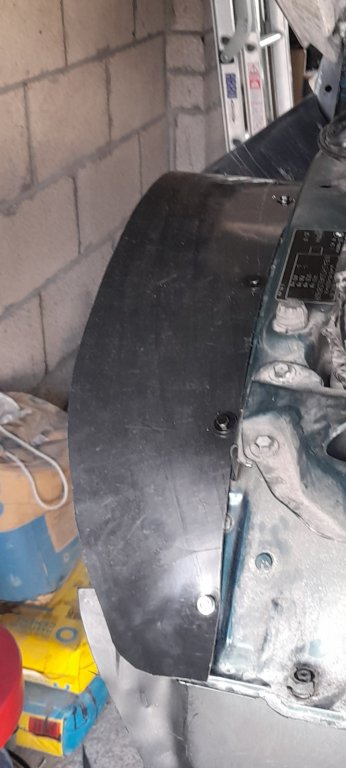

Wheel arch liners. Don't fit exactly but near enough and quite neat.
Edit.
Forgot to mention. The plastic sheet is one of those black plastic builder's tubs you get in B&Q. I tried 4mm rubber sheet but too wobbly. This B&Q tub is real easy to cut, very flexi but quite rigid once screwed in place.
