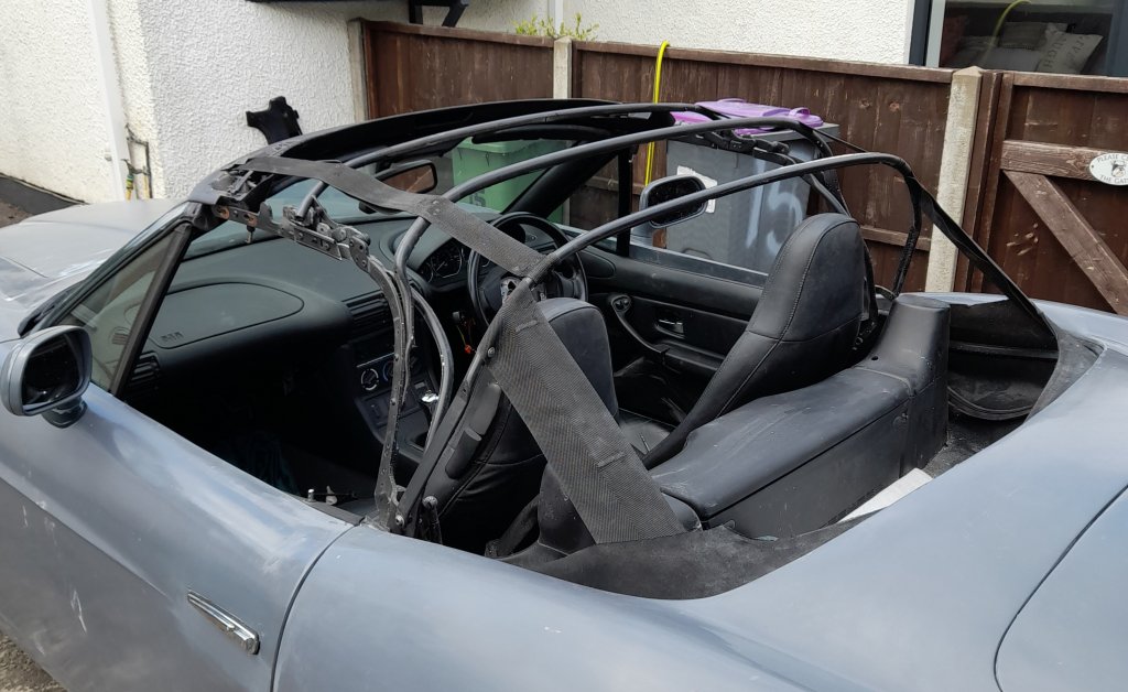

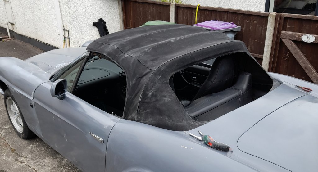

Soft top got pretty dirty with all the GRP work I've done.
Rear window was already out. Stitching all rotted away. So off with the material.
Whenever I opened the roof it wouldn't always fold back easily. One of the joints would stick and I'd have to press down on that one joint.

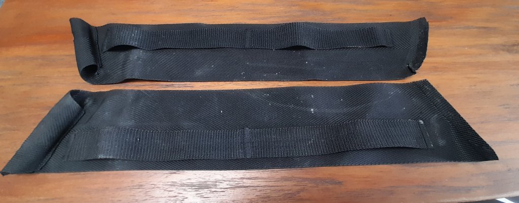

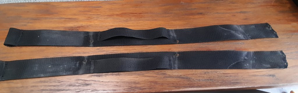

I've since discovered that the reason is that the straps are supposed to include an elasticated section that pulls the middle bow back slightly. Just enough to click the joint in the right direction.
Here's that elasticated section.
Anyone with an old Z3 that doesn't have lining. Look up at the straps and it might have that sagging section in the middle. Like the elastic on your favorite 25 year old underpants it won't have any elasticity. It just hangs there.
Looking online I think I can buy new straps. But if they're old stock then they might not have much life left in them.
So gonna unstitch the elastic and stitch in new.
You can see the stretched/dead elastic sections on upper and rear straps.

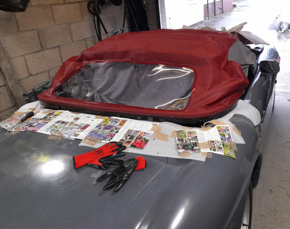

Thanks. I was hoping for a sunny day. But just had clouds and rain.
Tomorrow I'll put the heat gun in the car for an hour. Then a little weight on top and a push from behind and let the heat do its stuff.

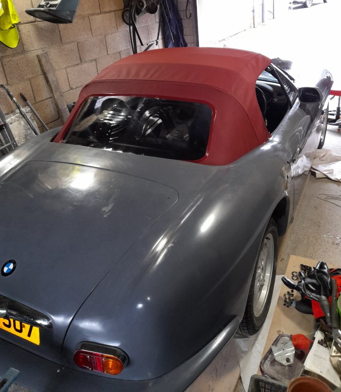

Roof closed. Really tight. Baking in the sun.
Bit of a crease in that panel above the petrol flap. Shoulda maybe tacked it a bit tighter at the very ends of the tack bow. Too late now. There's a flap of material to wrap around the frame just by that crease and maybe I can pull the crease when I get to that bit.

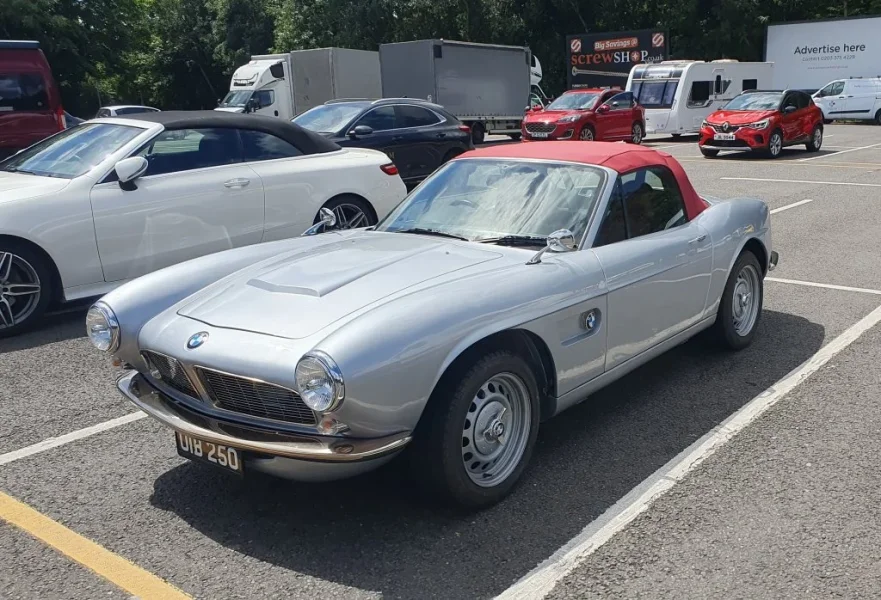

Opinions about wheels please.
First thing to remember - I'm not trying to make a replica 507 so I don't mind doing things different. Like the original Z3 door mirrors. I just feel more comfortable with modern-ish mirrors and not tiny chrome ones stuck way down on the bonnet.
I know others have gone for 507-style steel wheels with faux spinners. I don't think I'll ever bother with the spinners. But I do like the older style wheels with the 'pepper pot' look.
So. What about this guys?
I suppose I could paint the wheel middles body colour then they'd look not much different to the steelies others have used. But I kinda like the 'alloy' wheel look. What'dya reckon?
By the way - that's just a photoshop chop job. Wheels aren't really there. I'm just deciding whether to pull the trigger on a set. They're not too expensive either.

Agreed alloy Pepper pots aren't expensive, I think they are a good option and don't look out of place. Is that your final body colour ?
Duncodin
Sep 8, 2021
163
Pontrhydyrun - in Crow Valley
M44 FrankenZed
Currently that's the gelcote colour. RAL7015
I haven't decided on the final colour. Maybe close to the gelcoat colour or something like Mercedes Blaugrau. Here's a merc roadster in it.
I'd look for a bmw varient of that
First thing to remember - I'm not trying to make a replica 507. Things like the original Z3 door mirrors are there because I just feel more comfortable without tiny chrome ones stuck way down on the bonnet.
I know others have gone for steel wheels with faux spinners. I don't think I'll ever bother with the spinners. But I do like the older style wheels with the 'pepper pot' look.
I suppose I could paint the centers body colour then they'd look not much different to the steelies others have used. But I kinda like the 'alloy' wheel look. What'dya reckon?
I'm a fan of the steelies with spinners......I do like the pepper pots that you've photoshopped though.

They look good IMO. The only thing I would say is that they look a bit big for a '60s look car.
