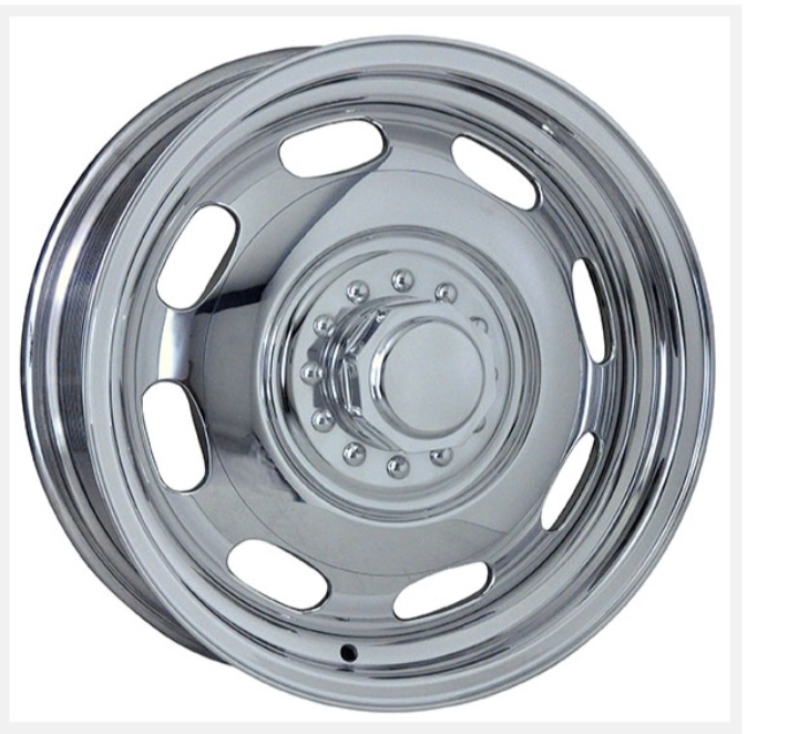

Currently playing with the VW hub caps to get that 50's 60's "Rudge" look. Have you seen the price of replica rudge wheels?
I don't think I'll do the faux spinners though. Looking at the big knockon hex centre nut idea instead. This is just a stuck on boot badge to cover the VW logo to see what it looks like. Hex nuts on order. I'll post another photo once it's all body colour with the hex nut. I like it though. Looks kinda correct.
This is the style I'm using for inspiration. (Except majority of 507 wheels were body color not chrome)

My only top tip on this would be don't try to make a copy of the original - you'll only be disappointed at the "misses" and not appreciate the "hits".
Make it your own and you won't care about the "misses" because they were your choice, not a "close, but no cigar" compromise.

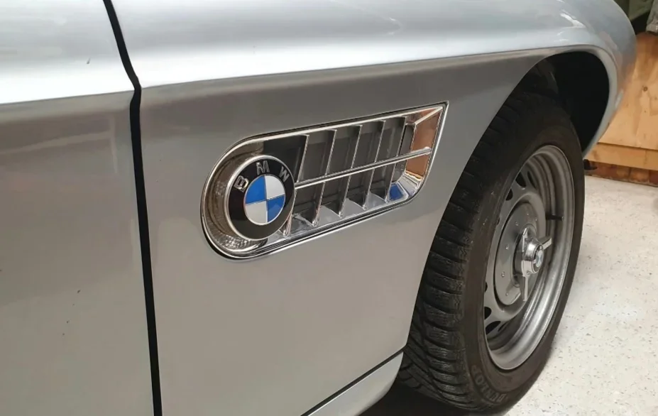

I like the wheel in the photo - it's nice to see someone has manage to use period profiles. It will be interesting to know how the handling and ride are. I expect it will either be limosine smooth, or bounce like a kangaroo. Either is ok, as you can damp the bouncing, and you can live with poor cornering if it glides like a Silver Shadow :)
The tyre is just a test to see if it would fit. Profile is way too high. It's 205/70x16 on a 7J wheel. I also have a pair of 6.5J16 wheels with 195/65. I think they will be the ones I go for but still thinking.
