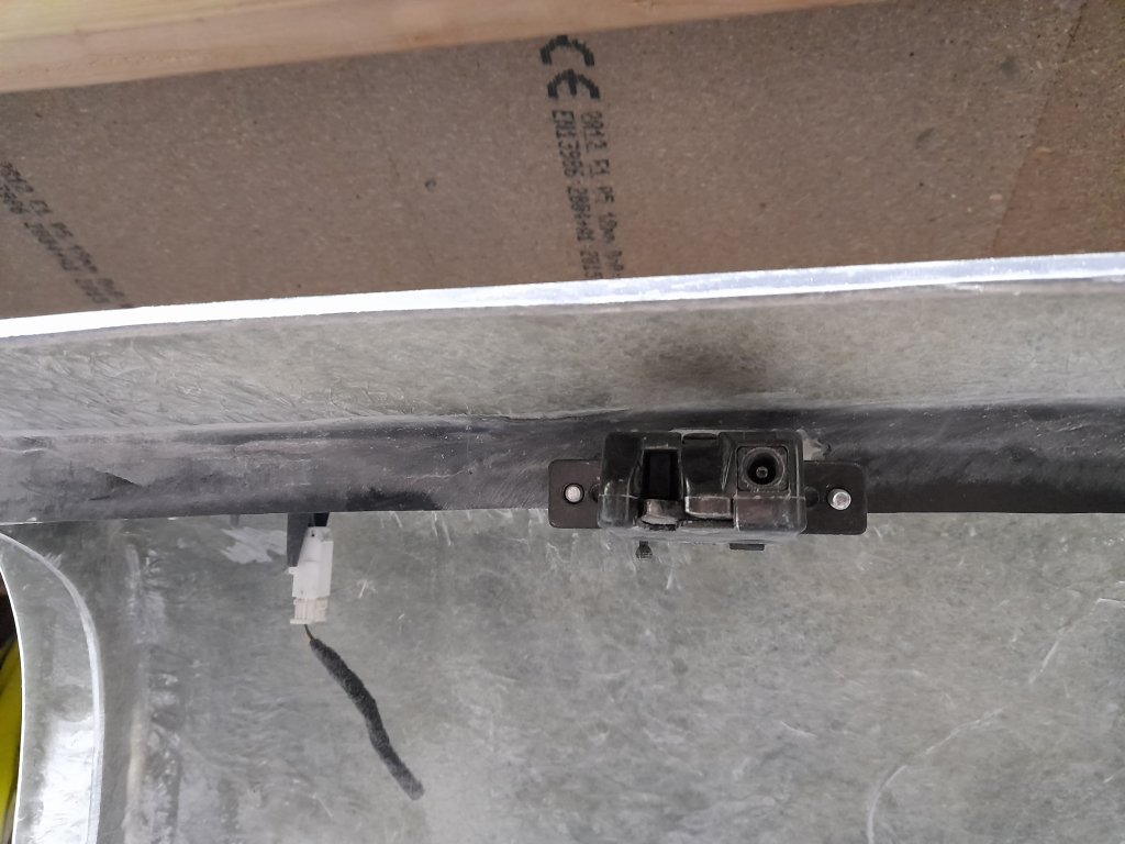

Boot lock. Chris at Tribute tells me that other builders use a VW lock/catch and fit the catch mechanism to the floor/rear wall of the boot with the striker above it in the lid.
Why is that?
I decided to ar least try to use the original Z3 latch and to put it in the bootlid same place as z3. The VW lock isn't expensive so I'm not just trying to avoid the cost. But i have the z3 lock so I feel that I should try to use it.
I'm sure I'll hit a problem and eventually fall back on the VW version. In the meantime though here's my z3 latch mechanism (still a bit wonky) in the bootlid.
I'm not planning on using the z3 key button. In place of the button I'll fit a solenoid to pull the lever on the latch when the button/switch on the boot handle is pressed.
Maybe one reason why others put the mechanism in the floor is that it's easy to rig up a failsafe method of opening the boot. I have thought of that and have a plan.
Why is that?
The Vw latch was easy to fit and I like that I can open it from outside. It just appeared neat and tidy fit for installing.

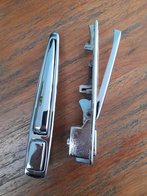

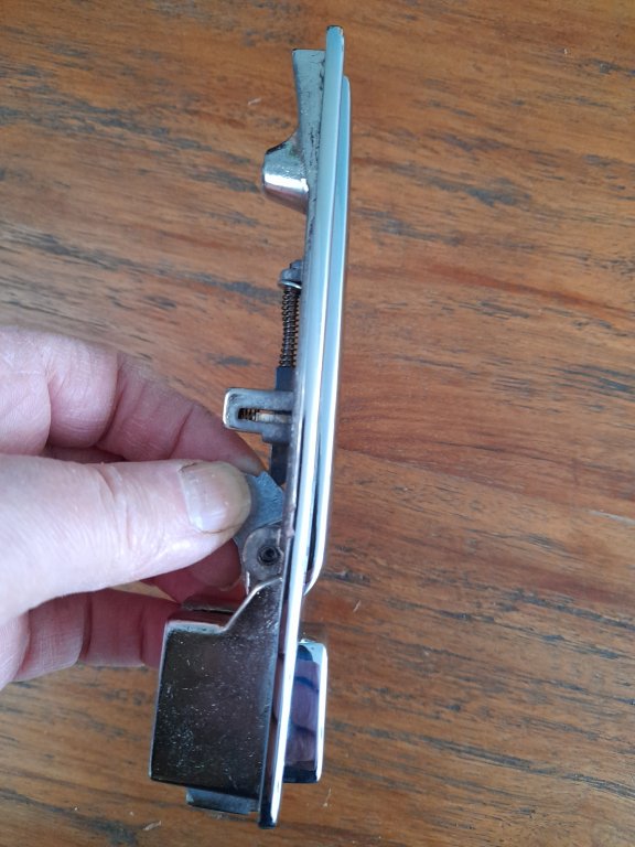

Originally MG handle was my first choice. Nice long plunger too.
and, to be honest, the MG handle is more comfortable to use.
MG = Grab the handle with your whole hand, press the button and pull the door open. Very comfortable
507= Nothing to grab. Press the button with a knuckle or thumb. Easier said than done because awkward hand position and needs quite a bit of pressure. Lever pops out just enough to get a couple of fingers behind to pull the door open. Lever is pointing forwards and, unless you push it back in, the lever stays stuck out so you can snag handbags off pedestrians if they're walking to close to the road.
So. Only my opinion. The 507 handle is a bad design. But it is good looking.

MG = function. 507 = form. I'm normally a function over form man, but in this case you look at it more than use it so might differ!! :)
