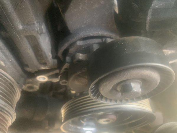

I’m just getting round to it now and I’m having issues getting the tensioner off (the unit).
Any advice to get the old girl off? I’ve even tried taking power steering pulley off but that sucker is stuck on tight!

Just a follow up to this...
I have managed to loosen the tensioner off, wahooo!
However... it’s currently stuck behind the power steering pump pulley! I’ve removed the 3 13mm bolts and the thing is stuck! I’ve try tapping it with a mallet wiggling it back and forth and even wd40’ing it and it won’t even budge!
Worth investing in a bearing/pulley puller to try and pull it off?
Cheers
Nick
Not the way to go Nick, you need to loosen the pump mountings and swing it out of the way. Don't remove the pulley from the pump.
