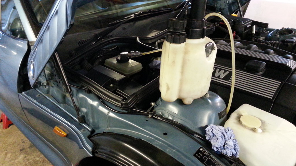

Well after a visit to the zed shed midlands branch today @t-tony the spanner Wizard worked his magic upon my brakes.........
And I'm very pleased and relieved to say that I now have brakes that work......very well :D.
Thanks again Tony for giving up your Saturday afternoon.......and the tea :thumbsup:.
Can actually do an emergency stop and make the a.b.s kick in :)

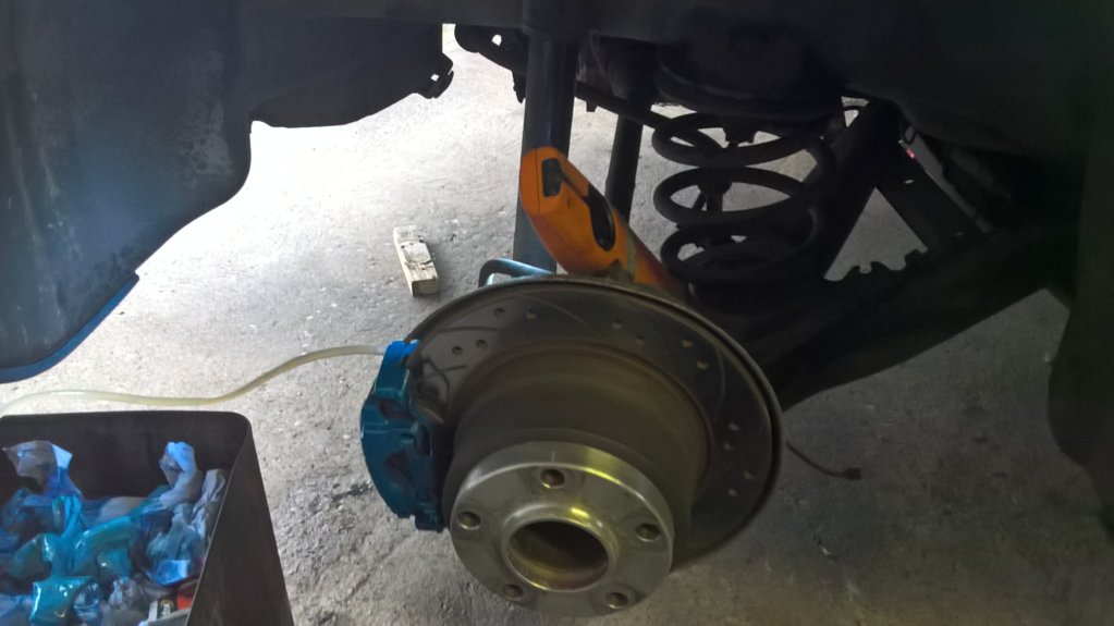

Everything seemed in order Sean,but we took the calipers off,cleaned up and lubed the slider pins,the pads were glazed so we deglazed them,lubed the pad plates where they slide on the carriers.
Resembled them and then pressure bled them.
All seems good now so I'm more than happy. Not quite as much feel as Tony has in his after fitting his new brake lines,they feel superb mate so maybe something else to add to the list :whistle:.

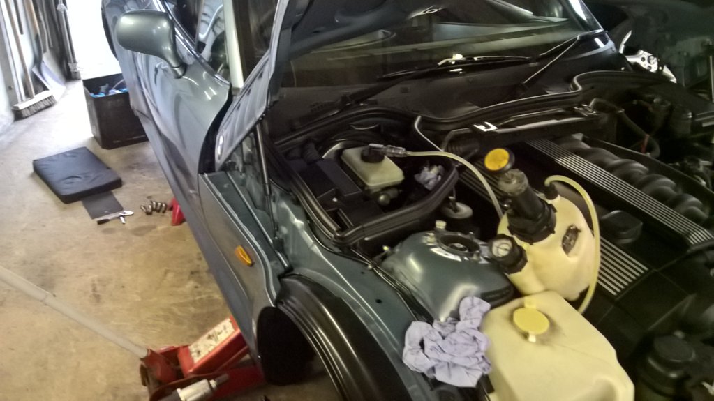

The high light of the afternoon's toils was the fact we've proved the repair on the pressure bleeder, now back to fully functional.:thumbsup:
The new apprentice proved to be a quick learner too.;)=))
Good fun today Steve, and the outcome we were hoping for too!:)
Bozzy
May 21, 2015
191
Long Eaton.
3 2.8
View attachment 46500 View attachment 46501
Yes I agree mate,enjoyed it and learned a bit more from the Jedi master :).
That pressure bleeder is a good bit of kit,made light work of that job :thumbsup:.
Really pleased with results of today,much appreciated.
