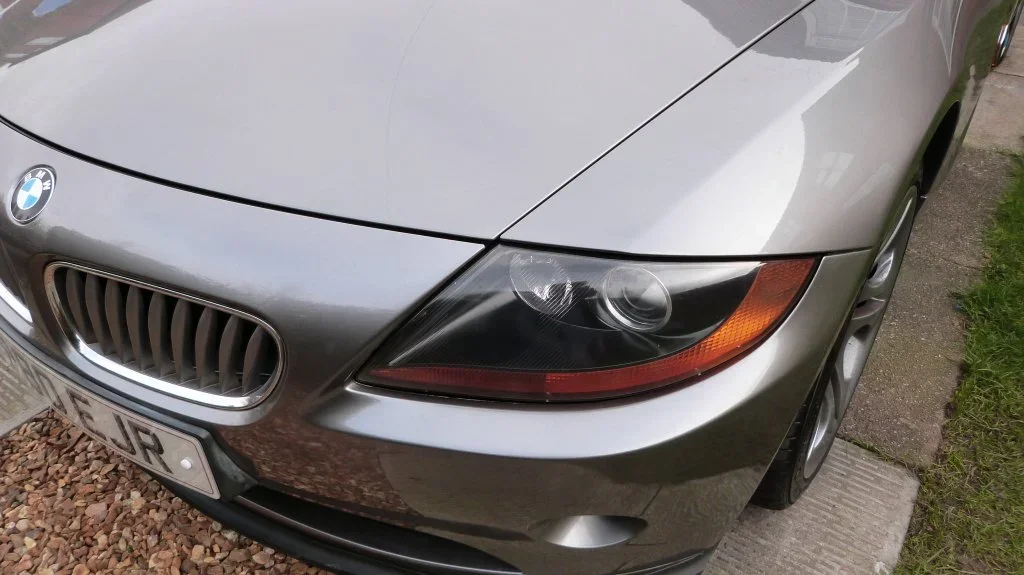

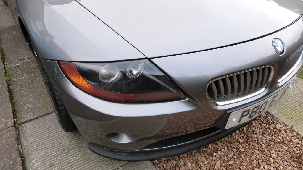

After recently sealing the headlights, or thought i had the lights have gone from worse to worse. So tried drying through the access flap under the wheel arch, that didn't work other than a smell of burning think my hot air gun may be a bit too warm for the job. So reluctantly took the bumper off, amazingly the side clips survived once again, probably the fourth time i have had the bumper off in 2 years so think i have been lucky. Headlights off fairly easy apart from one of the studs rounded off and needed drilling out. Took the inspection lid off amazing how much water came out but still plenty of condensation on the lenses. So what blows hot air but not as hot as the gun, yep wife's hair dryer another special tool i didn't know i had. Worked an absolute treat so after finishing off with a good clean looking good. Just the small matter of putting back on tomorrow and re fitting the bumper without breaking those pesky clips.
Paul, see if you can scrounge some bags of silica gel and put them in the back of the light units, should help.
