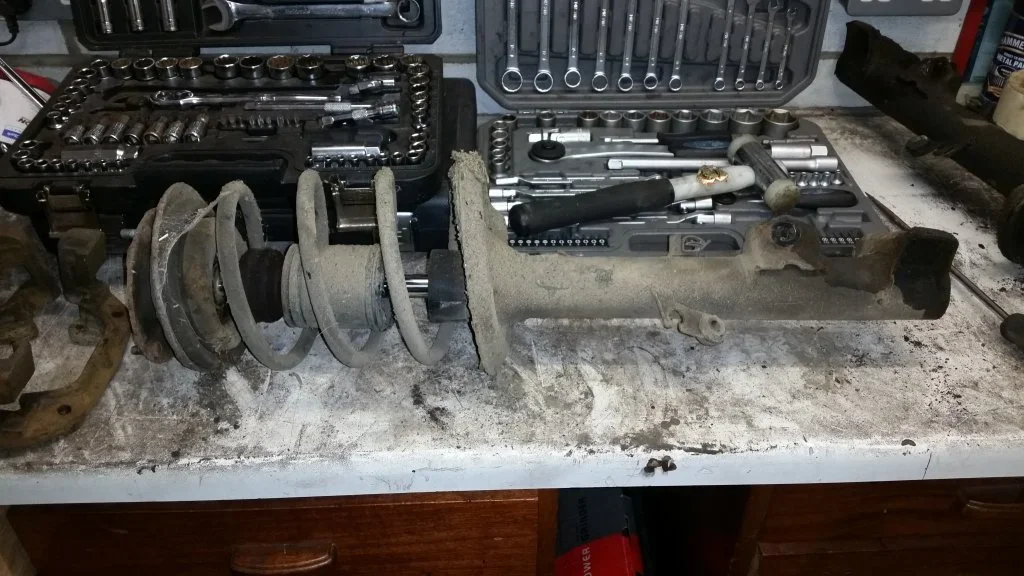

Shock absorber on the bench ready to break down. Few cobwebs to be swept away ;)
Spring clamps fitted to compress them enough so we can get the windy gun on them to remove the top nut.

Front springs Part 2! This is where it got fun... :)
We've had an interesting hour looking at a large collection of front springs and shock absorbers in the garage at the moment. The list includes
  • 2.2 Sport front springs off my car - supposedly 15mm lower than standard
  • 2.2 Boge branded front shock absorbers (new from GSF)
  • 2.2 original front shock absorbers originals from factory and branded so.
  • 2.8 Front standard springs originally fitted to Blue
  • 2.8 Front standard shock absorbers originally fitted to blue
  • Z3 M Roadster front springs, originally fitted to Lees old ///M (Sophie)
This allowed us to have a really good comparison of spring/shock lengths and take some useful pictures... There will also be a follow up discussion about springs later on in a new thread.
Picture 1. Duncan had supplied some shorter front shock absorbers, and this picture shows the height difference between the two. His original springs were fitted to the shorter shock. Original shock on the right, and shortened on the left - to the eye looks to be around the 20-25mm mark.
Picture 2. From left to right. Factory fitted 2.2 Sport shock absorber - Blues shortened shock absorber - Blues original shock absorber. This picture gives a really unique look at the difference in heights between them. (The 2.2 shock may have sunk a little while it was waiting for me to take the picture already!)
