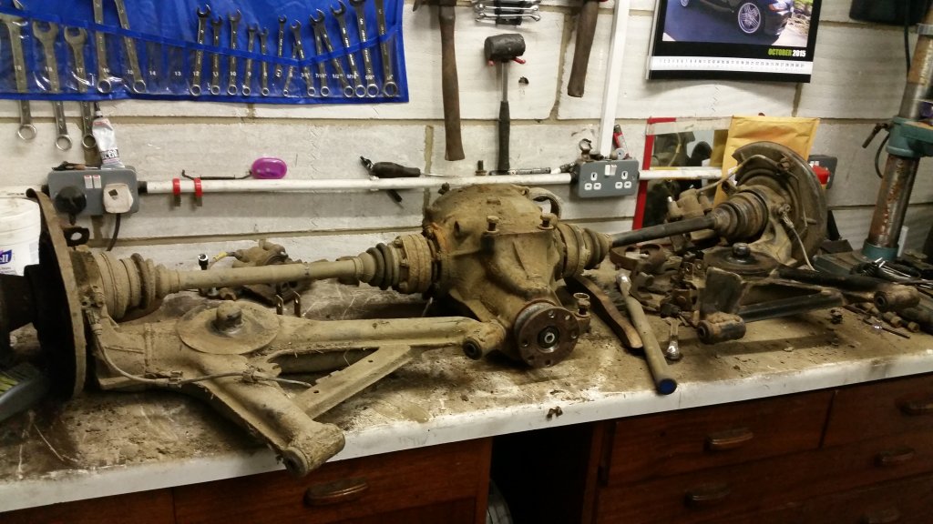

On the subject of khaki coloured sub frames... Apparently it's not, it's just covered in muck! Lee gave on side a quick go with a stiff brush, and it's standard black underneath. Pics for proof ;)
Resting on the bench, torn down ready for reassembly. Lee is going to spend some time tomorrow cleaning up some of the parts like the calipers and caliper carriers.
So now it's just waiting for parts to be ordered and arrive, and we can reassemble and refit the sub frame most likely one evening next week. We are then going to turn our attention to the front suspension.

I just loved a comment on FB about this pic.......:D
"What has exploded"?
Jack Ratt
The West Country
Dec 3, 2013
TRURO, CORNWALL
2.8i AUTO and 2.8i MANUAL
Nice one Mike =))
Looks like 'er indoors has emptied her handbag =))
