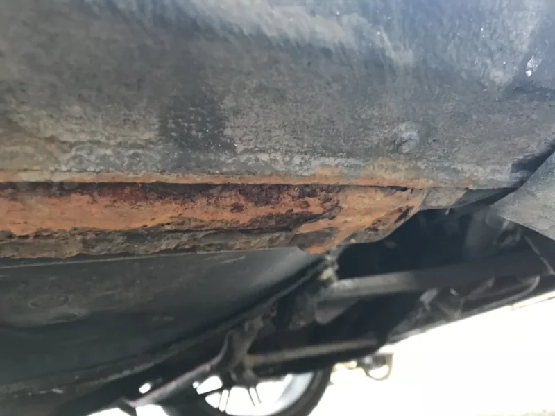

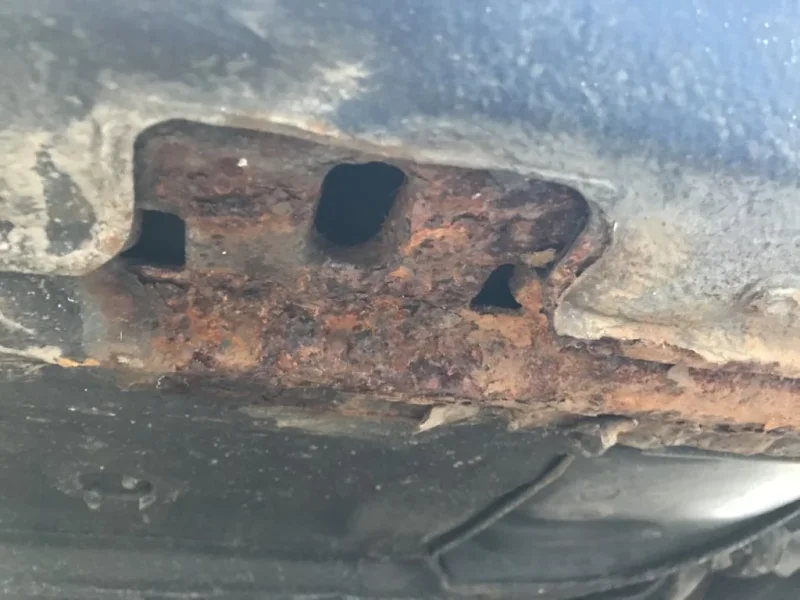

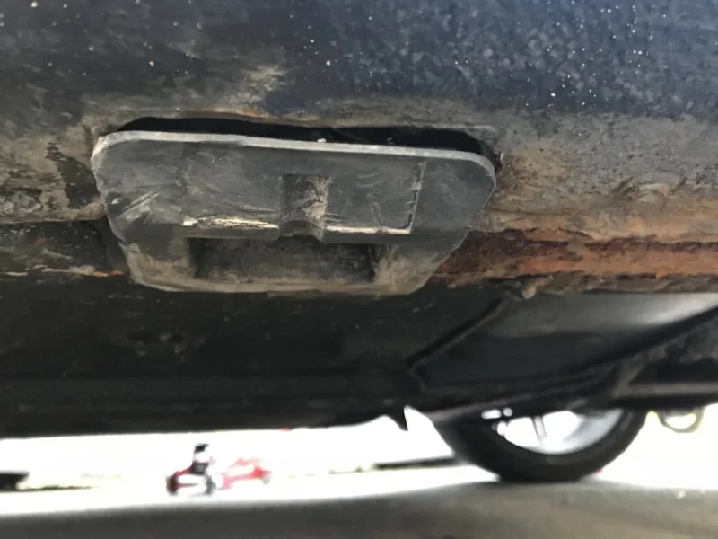

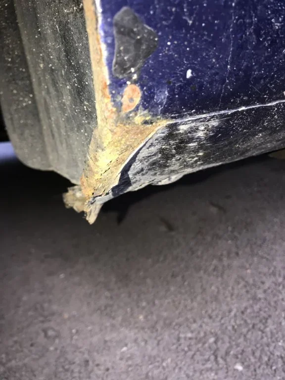

Yes, the sills are truly rotten as far back as the jacking pointsDid it fail on the outer sills Jim?

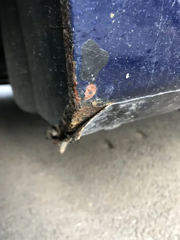

Yes the sills are bolt on. But was told that if the corrosion is within 30cm of a structural join (I think) then its a problem.The outer sills are bolt on panels are they not? That makes them bodywork in my eyes, not structural. I will ask when I go on my M.O.T.training next month as one of the topics is corrosion I understand.
Agree. I knew they needed doing anyway when I bought the car so just gives me a push to get the sills sorted properly now.The outer sills are not even attached to the jacking points, they are just trim panels which go around them.
Whatever is behind the outer cover is the structural part. The sill covers are no more structural than the front and rear wings.Agree. I knew they needed doing anyway when I bought the car so just gives me a push to get the sills sorted properly now.

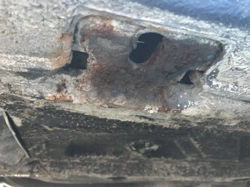

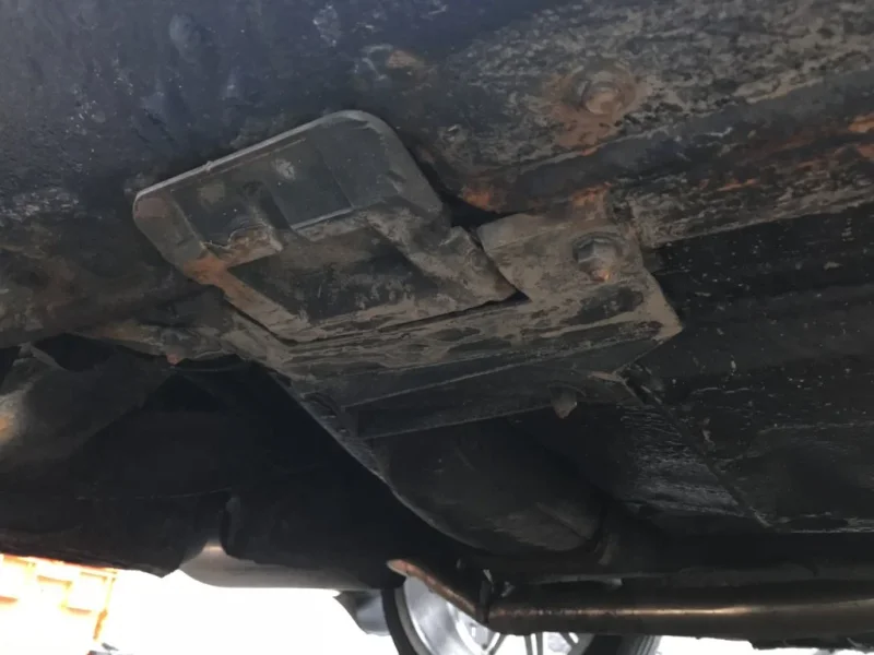

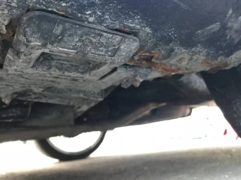

More concerned about what the actual sills and jacking points are going to be like once I’ve removed the sill covers.![]()
Agree, but I need her to look prettyWhatever is behind the outer cover is the structural part. The sill covers are no more structural than the front and rear wings.
Absolutely Jim, I'm not disputing that it should be repaired and look it's best, just that I don't think it should have failed on those sills. As I said I will get a definitive answer next month.Agree, but I need her to look pretty![]()
Agree @t-tony. As I have been following a lot of recent posts and discussions about sill outer skins / panels.Absolutely Jim, I'm not disputing that it should be repaired and look it's best, just that I don't think it should have failed on those sills. As I said I will get a definitive answer next month.
