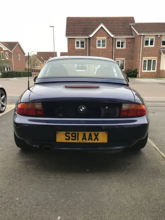

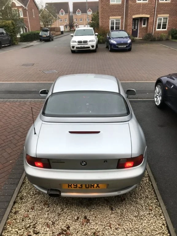

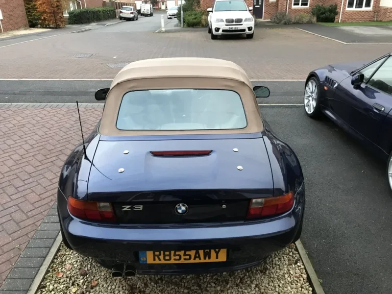

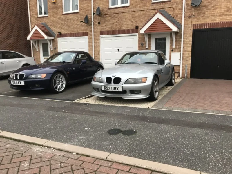

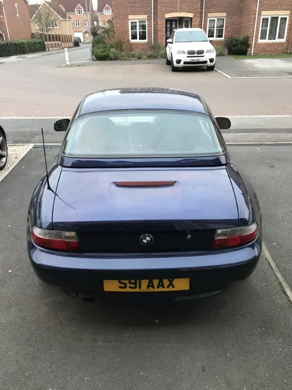

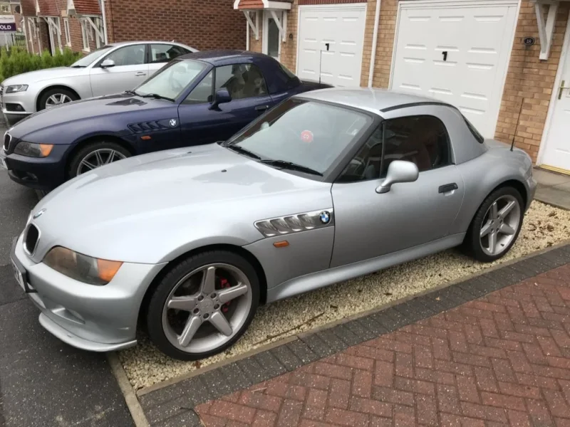

The Silver Zed got treated today to a hardtop and fitting kit. Managed to get them for a bargain :D

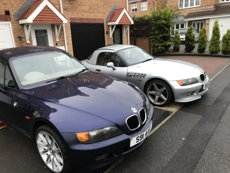

So now both my Z3s are set for the winter
The Blue one is jacked up at the rear at the moment as I’m sorting out the handbrake, cleaning everything up and sorting out the rust spots.
Really liking the hardtop on the Silver one, feels like a completely different car.
The fitting kit went on easy and everything lined up well first time

So what wheels are these?? Looking good!
Silver Z3 is on 18” AC Schnitzer Type 2 Non-Racing - Staggered
Blue Z3 is on 19” OEM BMW MV4 - Staggered

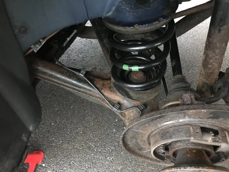

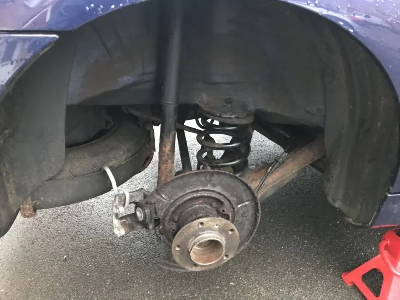

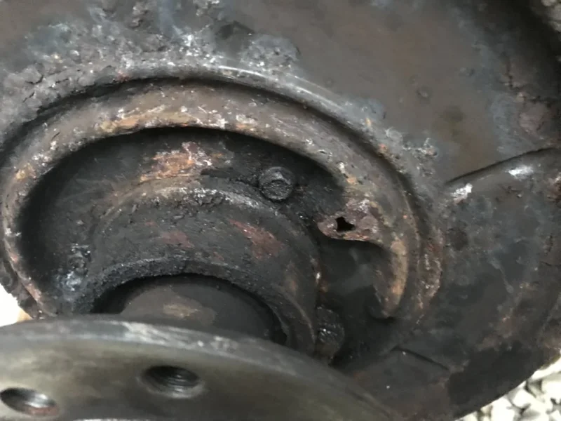

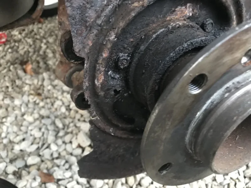

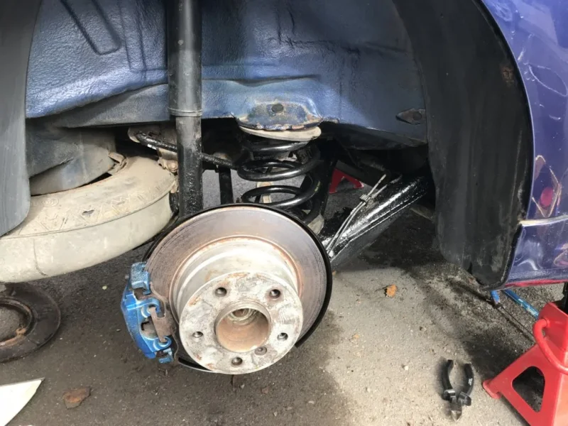

Got the Blue Z3 handbrake sorted finally.
When I bought the car she had been sat for a year :( and the handbrakes had rusted on. So I had to pull her free with the X5 to release the handbrake shoes. In doing so it caused a rattle on the drivers side rear wheel. Experience told me that it had pulled the handbrake retaining clips off and the spring was loose and rattling around in the hub.
Once I’d taken the rear discs off, my suspicions were correct. The passenger side handbrake was fine, but the drivers side was FUBAR’d. Where the 2 retaining clips for the handbrake shoes attach to the brake dust plate, the holes were severely rusted. So by pulling the car loose it had ripped the clips straight through the plate. Result being a new dust plate required.
So after fitting the new plate and new shoes, I though I would clean up the arches and attend to any rust areas. Overall not bad for an 18yr old car
4173DB43-B871-477C-8A06-CB6D85856A1B.jpeg 41E2FAF9-5B86-4A6E-84B2-4B2739BEB147.jpeg

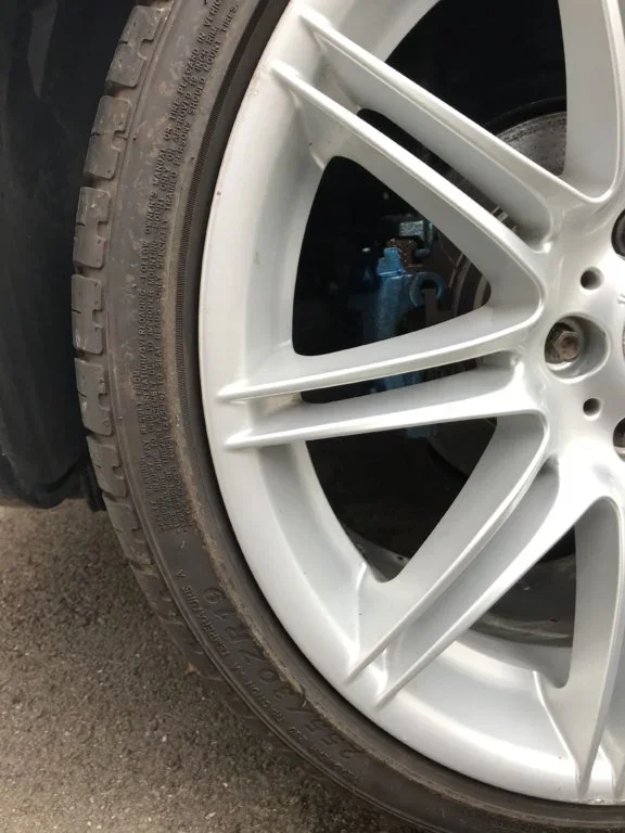

Even gave the calipers a coat of blue paint ;)

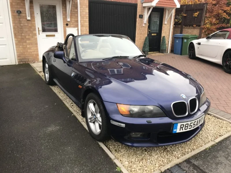

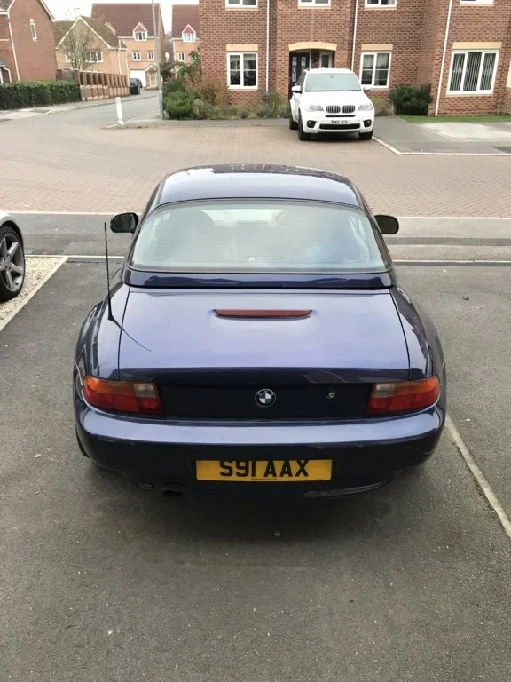

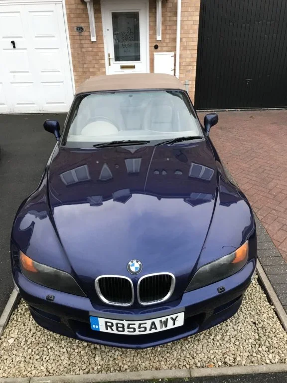

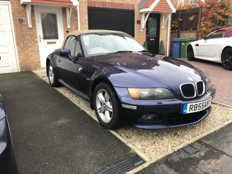

Ohhhhh dear what have I gone and done now.....
:whistle:
A08998C9-6F24-45E9-AD0E-31718F764E1B.jpeg 1288731B-6E59-4ADD-9B15-08C48BD5B6F3.jpeg E76759F4-490C-4A37-8D6F-E6625D3B7BB1.jpeg 5F9A9D87-23DB-4903-9B7A-9EE6A172B8B6.jpeg 0465BC9F-30D9-4853-A026-CE20C3CDCBEC.jpeg 25ABC41F-A96D-4F3F-9275-65BB278216AD.jpeg
Still have the Silver one as well but it’s off getting its battery tray welded :(
But at least it makes space for the new one ;)

They are breeding, do something!!!
Is it a 2.8? Did you buy it to keep, or to break?
