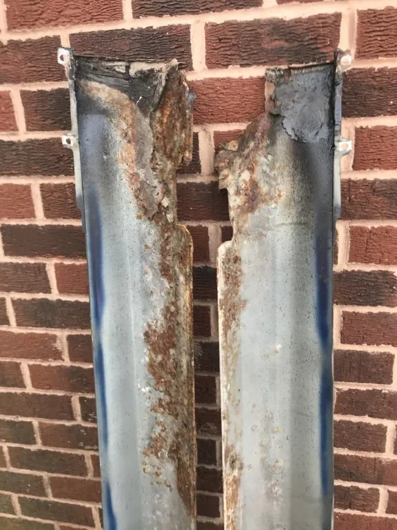

Yesterday I started to remove the outer panels (wings and sills) and I've made a start on getting the old power steering pipe out.
Good news is that the remedial work I did a couple of years ago it holding up. The outer sills, however, are well past their sell by date!
