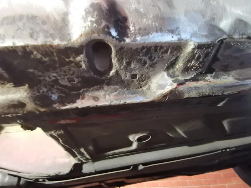

What was supposed to be a reasonably easy job has turned into an epic
When I said the remedial work was holding up, it actually hasn't. When I did the inner sills a couple of years ago I intended to remove the jacking points and protect underneath but didn't get round to it. The POR15 hasn't really worked where I did paint, so have decided to re-do the full lot.
When I took the front and rear wings off, it was all good under there with only a couple of small rust spots to be dealt with. I cleaned up underneath and treated it with Bilt Hamber Dynax S50
For the inner sills I started with all jacking points looking like this :(
I stripped these as much as possible using an abrasive disc on an angle grinder which got me to here.
I then treated them with Bilt Hamber Deox Gel which eats away the rust, which got the points to this state (sorry about my face!)
I then stripped the rest back to bare metal using a flap disc (might as well do it all properly)
And applied Bilt Hamber Hydrate 80. This converts any remaining rust and acts as a barrier to stop the rust coming back
It's then had a couple of coats of Electrox Zinc rich primer. Whist it's not perfectly smooth I just need it to be functional and stop the rust coming back
The next steps are to give them a couple of coats of Epoxy Mastic and a coating of Dynax UC and treat inside the sills to Bilt Hamber s50
All of the new panels have been treated to Dynax UC inside to protect them
And so the car is now sitting like this
