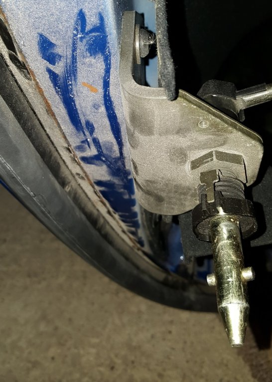

Cables wise drivers side is earth passenger's is positive with the proper connector. I can't find any pictures of a Wiesmann Kit to compare it so I am still stuck.10mm is not too far out, 5mm either side, I would imagine you could manipulate the existing brackets to suit however if you do get it to fit you still have no adjustment on the x-y axis.
I notice that you have a cable coming from both brackets, these wires are for the heated rear window. The OEM brackets are only on the passenger side.
I am 99% sure your kit is a Wiesmann kit, to be able to fit an OEM roof you could look to swap out the kits, I would imagine you would be able to do this on a cost neutral basis.
