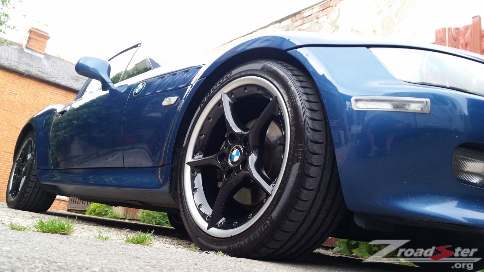

Just had her cleaned, so would be rude not to post a picture!
Car looks great on those wheels Gaz.:thumbsup: Shame about the green furry bits in the foreground.=)) JUST got our drive weed free since coming back from Florida, block paviours = nightmare with weeds.:(
