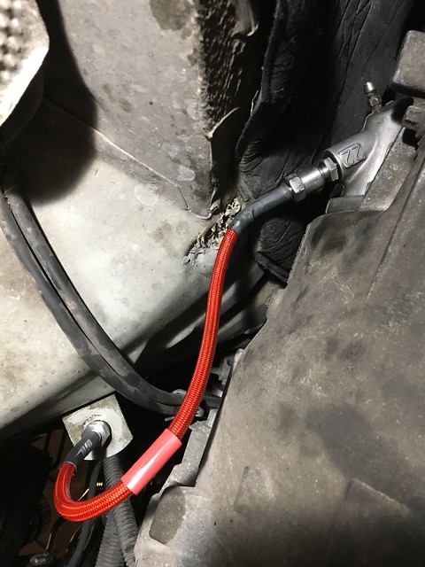

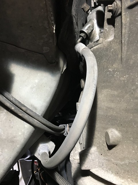

Next was the braided clutch hose, normally a mod done to remove the CDV although mine didn't have one.
Standard
New
Notice how the new one doesn't have the 45 degree bend at the master cylinder meaning it sits very close to the body, ideally it needs the bend as we had to knock the body back slightly so it won't catch and break if there is any movement in the gearbox. And honestly for the hassle it was to change it, there has been no noticeable difference whereas there is when you replace one for one with a CDV.

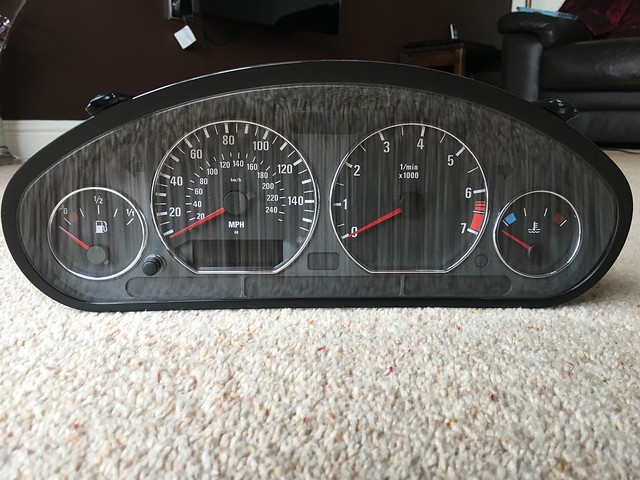

I've also added some colour to my needles on the speedo, similar to the ones fitted to the ///M and whilst it was out I put 3 LED bulbs in which has brightened it up a bit. I do have another mod which I have done but I need to change it so I will update on this when it's finished :ymdevil:

Very nice pal, top work as normal, where did you source you LED dash bulbs, mine is coming out at the weekend for a colour change so I may as well replace the bulbs.
g8jka
178
Telford, Shropshire
Z3 - 2000 2.8 Roadster
I only replaced the 3 main ones which light up the cluster. They are just standard 501's you use for sidelights. When you split the cluster you will see them, just pull them out and put new ones in or twist out the holders from the rear and pull them from the holders when you have twisted the holders out.
Sean d
Sep 29, 2015
201
Lincolnshire
Z3 2.8
Thanks pal, I never realised they where the same as the side lights.
g8jka
178
Telford, Shropshire
Neither did I, if I knew it was so easy I would have done it a while ago. You can get the LED versions of the warning light bulbs I think and there are around 20. I couldn't be bothered with these though as they only work one way and I didn't fancy changing them and having to try each one with the cluster back in to check they were all working although there is probably an easier way to make sure they go in correctly to start with.
