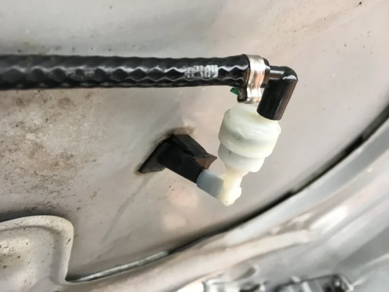

My windscreen washers stopped working recently, just in time for winter when they are needed. The mesh filter at the bottom of the pump was all caked up with crap but after cleaning it all out they still didn't work. Had this trouble on my old zed and it seems once the filter is blocked up enough it eventually damages the non return valves and they need replacing. I got a couple of new ones from Sopers, cleaned everything up and fitted the new valves and all is working properly again.

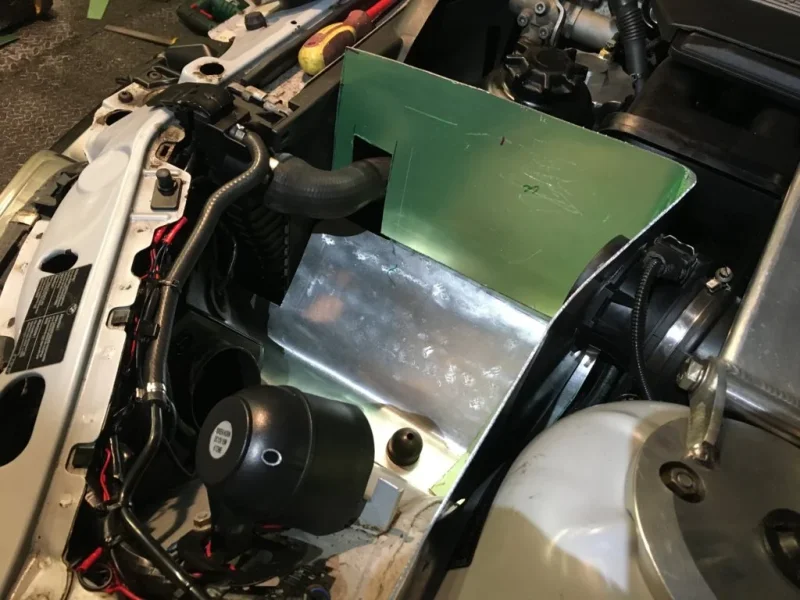

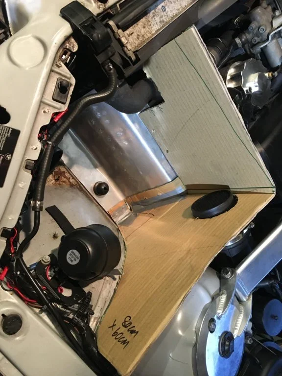

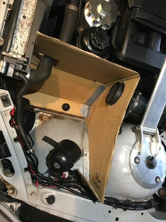

Another project I've been wanting to do for ages is to make a heat shield to go around the cone filter.Made some templates up from cardboard to start with.
The pipe that goes from the rad to the expansion tank is in the way as it runs up the side of the original air box and I'd need to make a cut out in the shield for it to fit. I thought about one from an ///M as these go around the side of the engine bay but I didn't really fancy spending £130 on a bit of hose so I cable tied it around the side following the loom. It's actually a pretty good fit and doesn't get in the way anymore.

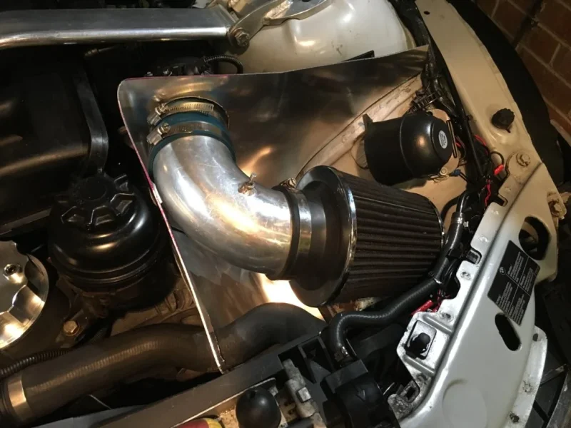

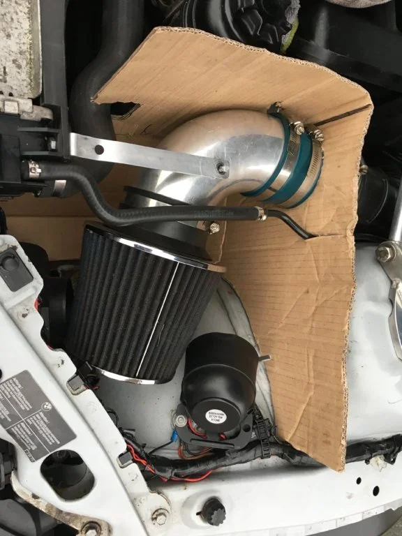

More templates were made before I got a fit I was happy with. Made it in 2 sections one for the bottom and another that wraps round the back and side of the engine.
Getting there

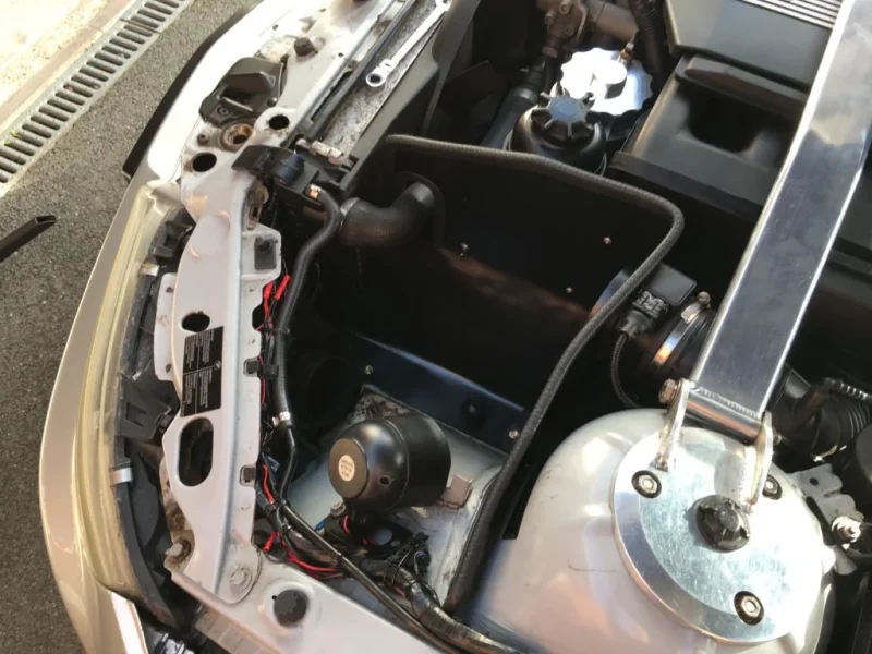

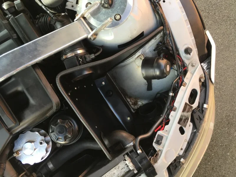

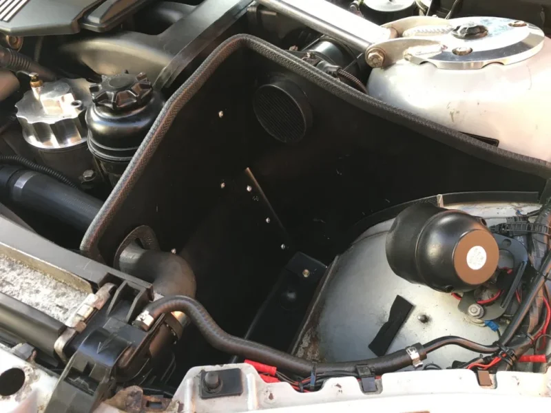

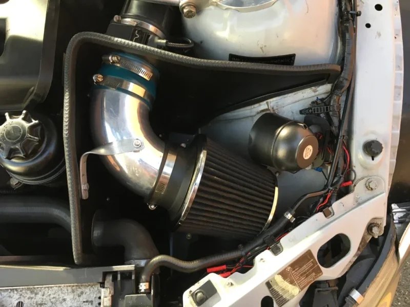

I decided to spray it in matt black so it looks a bit more OEM, might even carbon fibre wrap it eventually. Put some trim around the edges to neaten it up and fixed the bottom part with a couple of self tappers to the chassis rail and riveted the 2 parts together. I used one of the old brackets from the filter to attach to the shield to keep it nice and solid and another one from to keep the filter secure.
On the 2.8TU there is an integrated cold air feed in the headlight housing which directs the air straight to where I have the filter positioned. You can just see it below.

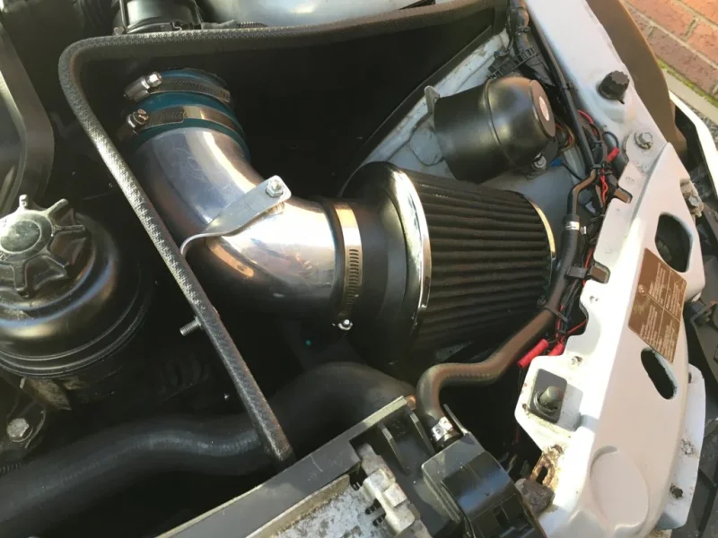

And all finished.
Whether it makes any difference I don't know but it has been going well recently. It certainly picks up and shifts well now. Next maybe a new filter but I'm going to put another cold air feed in from the front grill directly up and through the bottom of the heat shield to the filter.

I would have gone to the right of the rad hose like yours but the way my filter is I had to leave a cut out for it. I don't know if mine is high enough to sit flush with the bonnet but it can't be far off. It certainly feels cooler in that area so hopefully has made a bit of difference if not it looks a bit smarter. I want to make something that pushes the air from the front grille in the bonnet towards the headlight port as well at some point.
