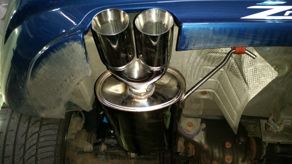

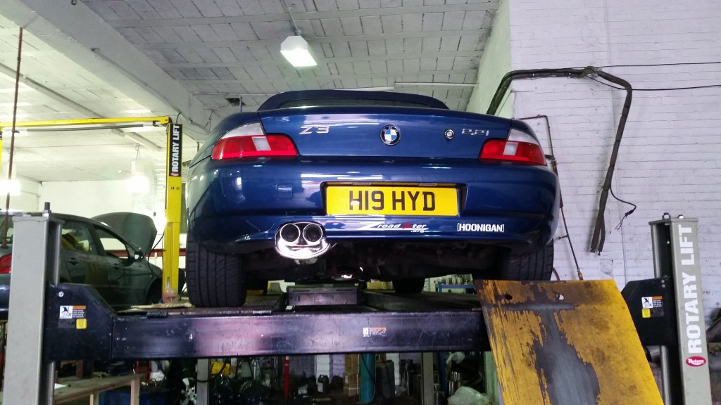

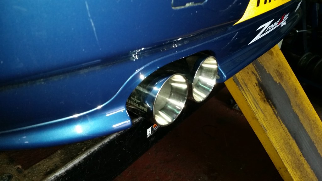

Ok, second attempt... Got it fitted and it looks A*W*E*S*O*M*E but the noise level we have now is almost OEM. I've just got off the phone with the fitter who said to drop back in this afternoon and he'll sort it ;)
Some pictures of the underneath and tail tips.

Look at the size of them tips! :wideyed:

The problem with the first one was it was almost oem in terms of sound but it had lost the pops and burble.
The centre box was removed and this brought back the pops and burbles. But not the exhaust note while moving.
3rd attempt seems to have got what I was looking for. I now have straight pipes and a straight through back box.
An awesome deep burble on idle and glorious sound on acceleration. Doesn't seem to droney at speed so far.

£360 all in, and the two changes he made to the system were all included in that price. The fitter, Matt, was really great about me being annoying though. He said it made a change someone wanting it louder, rather than moaning and asking for it to be quieter!
