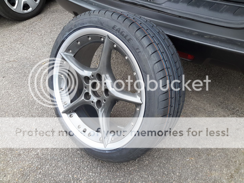

My refurb is finished and got tyres fitted this morning.
I had the rims powder coated after removing the dings and kerb marks myself. When they came back from the powder coaters, I had to run a tap through every hole in the rim and clean the tap each time as the threads clagged up with powdercoat. Took a complete afternoon to fit the centres back in.

Looks great Steve, did you get a clear coat on the rims.
Good job well done there :thumbsup:
