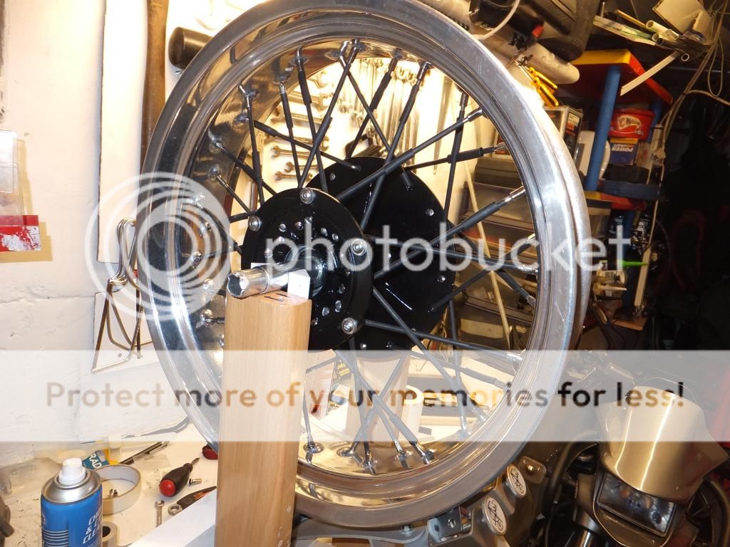

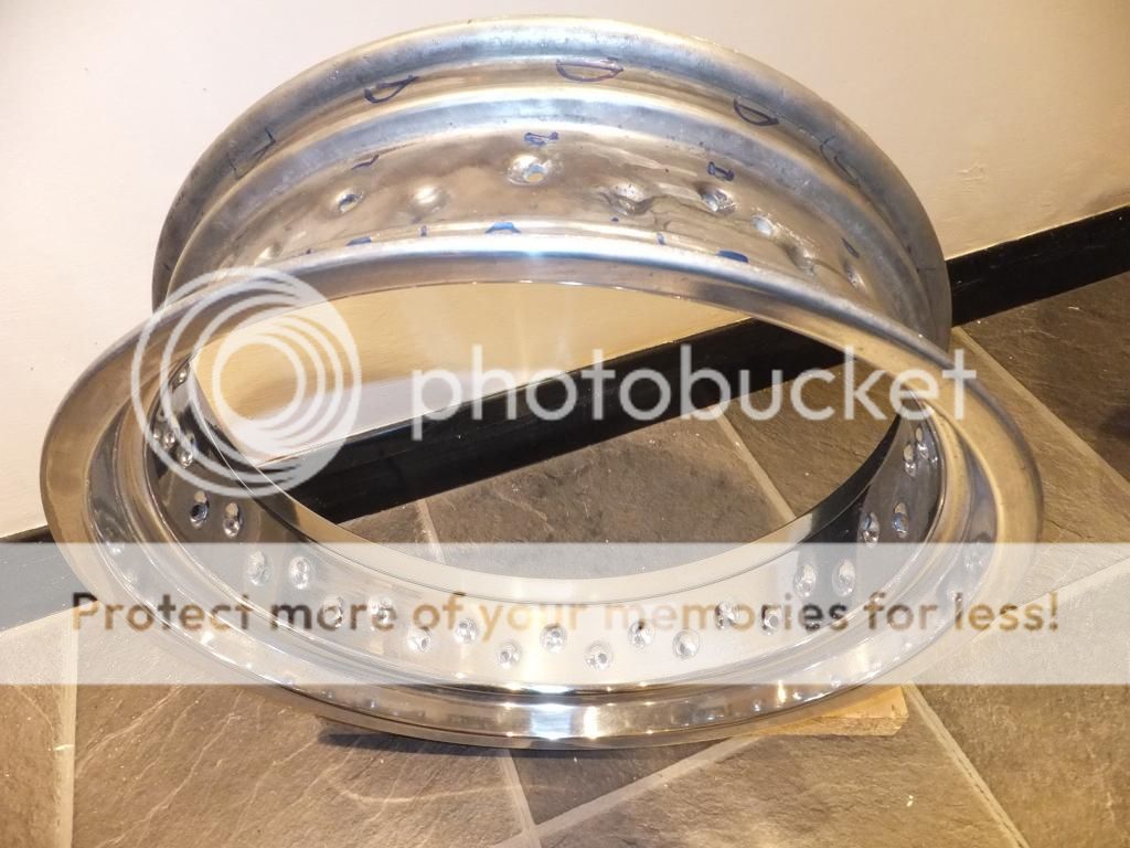

slightly off topic i know but heres the rims i refurbed on my supermoto a few years back and laced up and trued with stainless spokes... talc is your best friend too when polishing..

How do you use talc, never heard of it before
I had a quick google on this. It's used to remove fine swirl marks. I also saw someone discussing using flour to clean detailed engine components.
