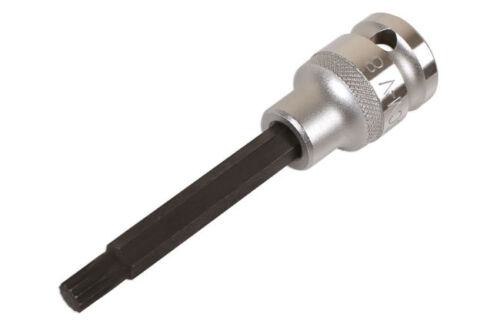

can anyone confirm the spline bit size please is it 6mm 12 point spline or 8mm 12 point spline.?
and any thoughts on what good quality make of spline bit i need to use.. would a shorter one be better...?
thanks Al
They are 8mm Al. I found a long bit best but have the wheels on the car and stood on its wheels.
thanks i found a spline bit whilst looking through my tool kit yesterday, dont know if i trust it but it does fit...
Mine isn't a well known brand Al. All you can do is try it mate, just make sure it's fully home in the bolt head before turning.

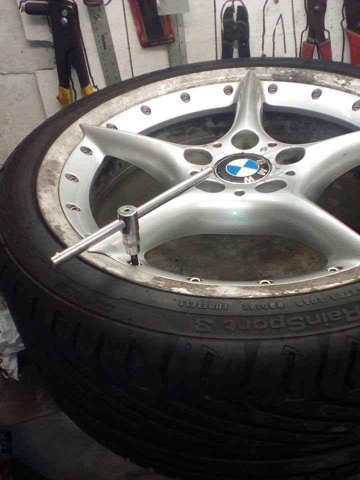

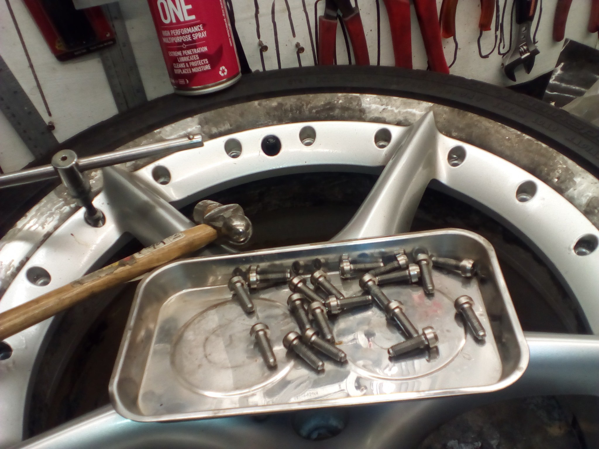

tense moment tonight.......

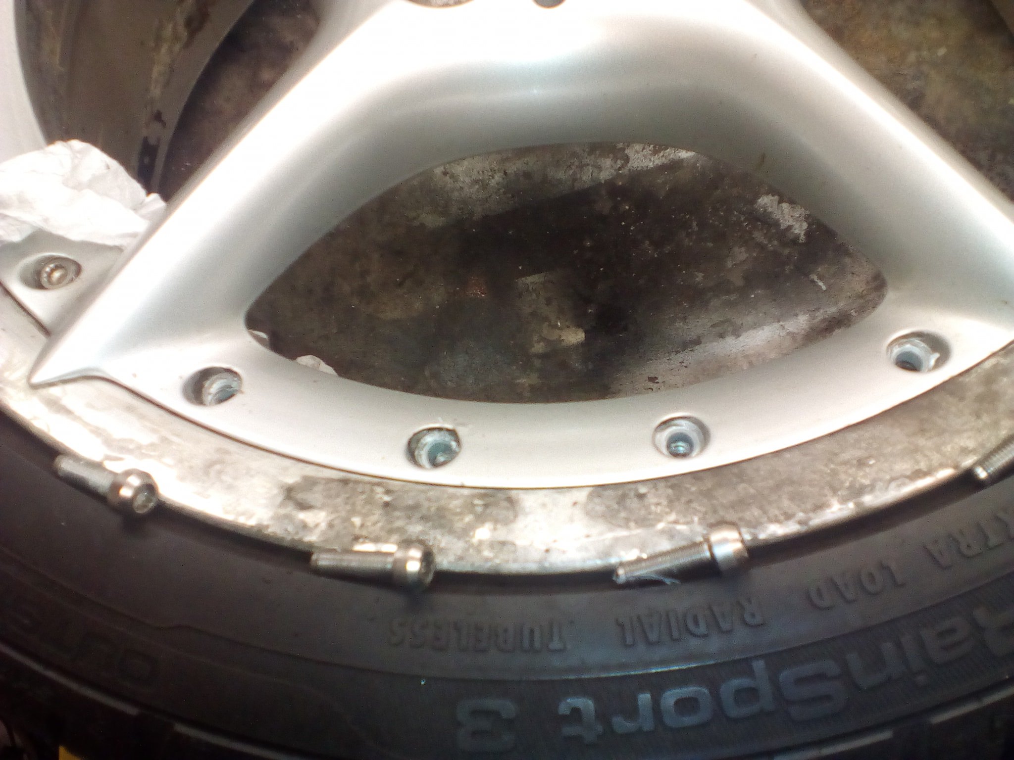

wheel number one all bolts successfully removed...
41926438_547598515676566_2472084090682081280_o by handsomejackuk, on Flickr

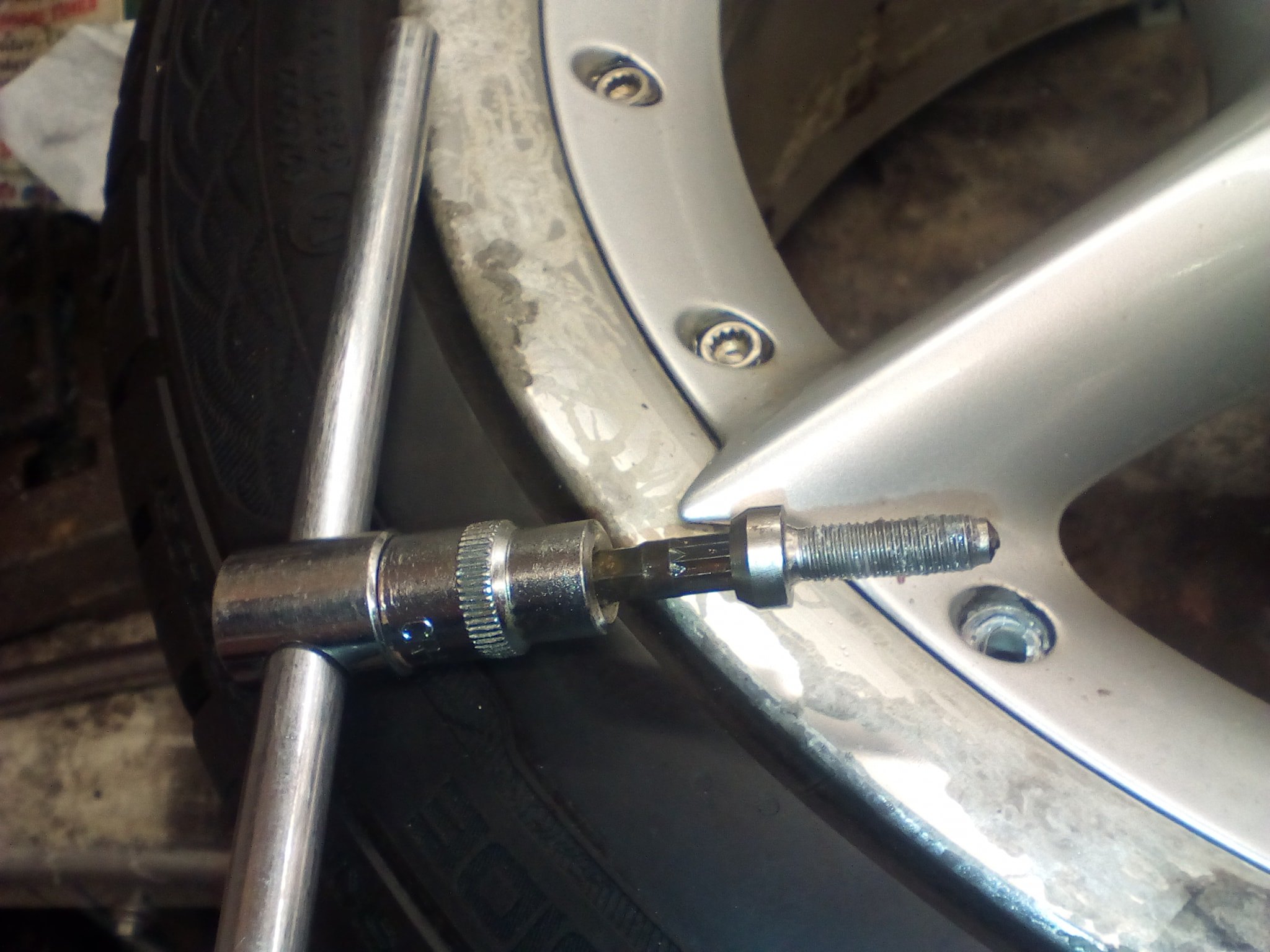

my technique was this..............
wheel on bench plenty of light to see whats going on
each bolt given a spray of xcp penetrating oil bought yesterday for £1.29
next step hit each bolt with hammer about 10 times with the socket and m8 spline bit to let it know who's boss..
next step spray again with xcp penetrating oil...
leave for 20 mins while having food...
next step relieve tension on bolt by applying a fairly constant torque on a 12 inch t bar in both clockwise and anti clockwise direction hitting with small hammer while maintaining the constant torque
i did this in pairs of 4 bolts..
then start undoing once its moving give it a small tap with hammer to thank it...!!!!!

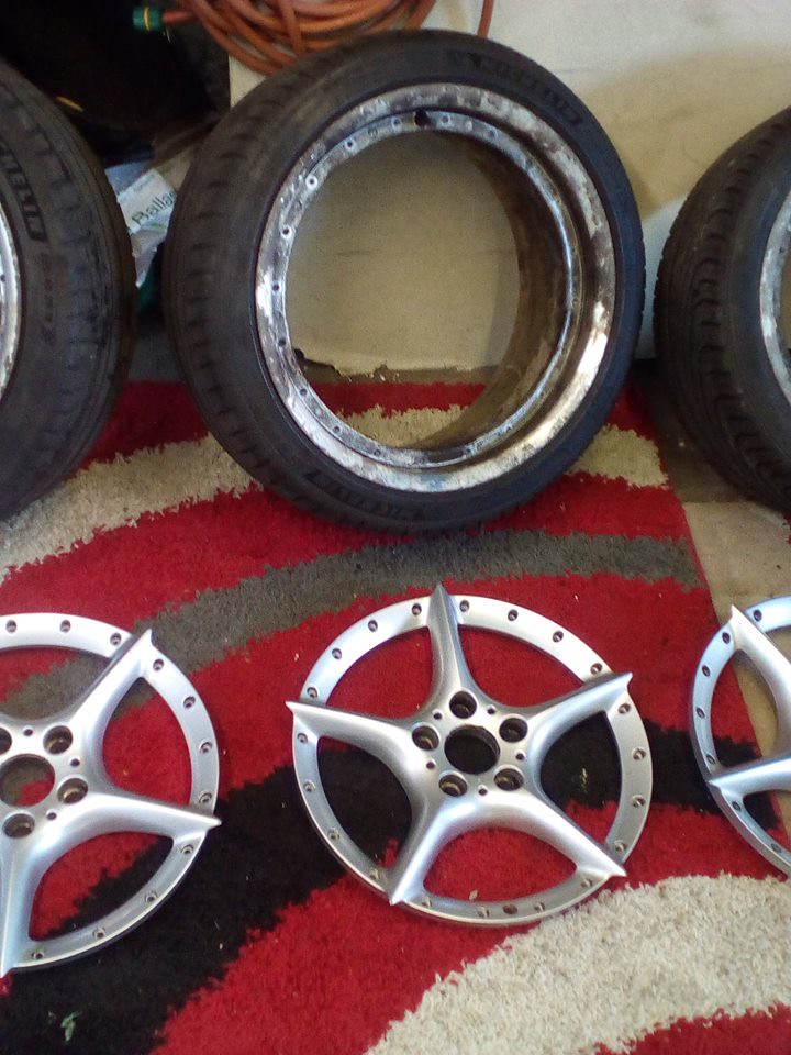

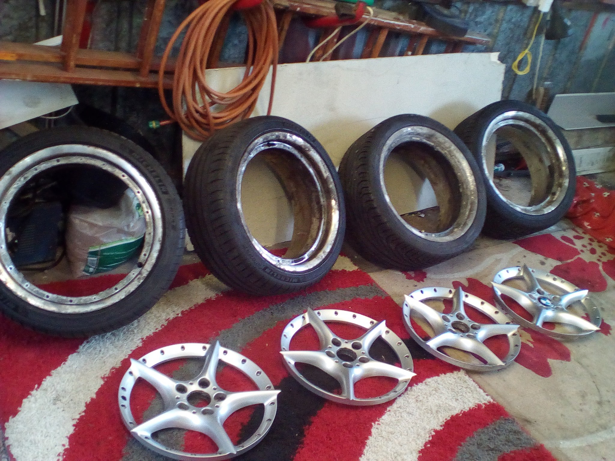

quick update.. successfully done the all the wheels, bolts removed successfully...
I can now look at stripping the paint off the wheels and deciding on what to do with them
went over powder coaters in merthyr yesterday, they were very helpful didnt have any samples there to show me but said they could do the centres for £30 each and the same for the rims. so £240... they would do a complete wheel unsplit for £45, but thats not what i wanted so i need to decide in the next few weeks what i am going to do with these wheels...
I may strip the paint off the centres myself and have a go at painting them but i did notice today that the rim centre i was stripping bolts out of today looked in pretty good condition and maybe able to just clean that one and repaint the other ones.. and i going to clean the outers
heres a thing....
so i have removed all the centres and kept them with the matching rims... I thought maybe the centres were all the same but it looks like the rear wheel centres have 8.5j stamped on them and the fronnt 8j on them.. looking on bmwwheels styles website, the rears and fronts have different offsets too et50 rear et47 front..
