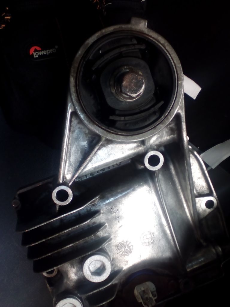

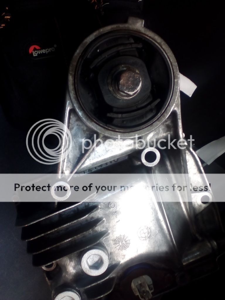

You can do it without removing the spare wheel Just push the heat shield to one side the bottle fits perfectly between5 minute job 1le of castrol syntrax 75w-140 remove spare wheel as long as car level just 2 hex nuts ...dont be tempted to over fill
