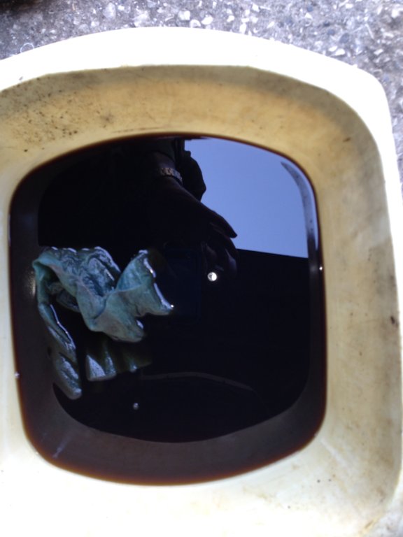

All done today, also flushed the coolant.
I found the most awkward thing was refilling the gearbox. It needed doing as justified by the colour of the fluid that was drained out!!

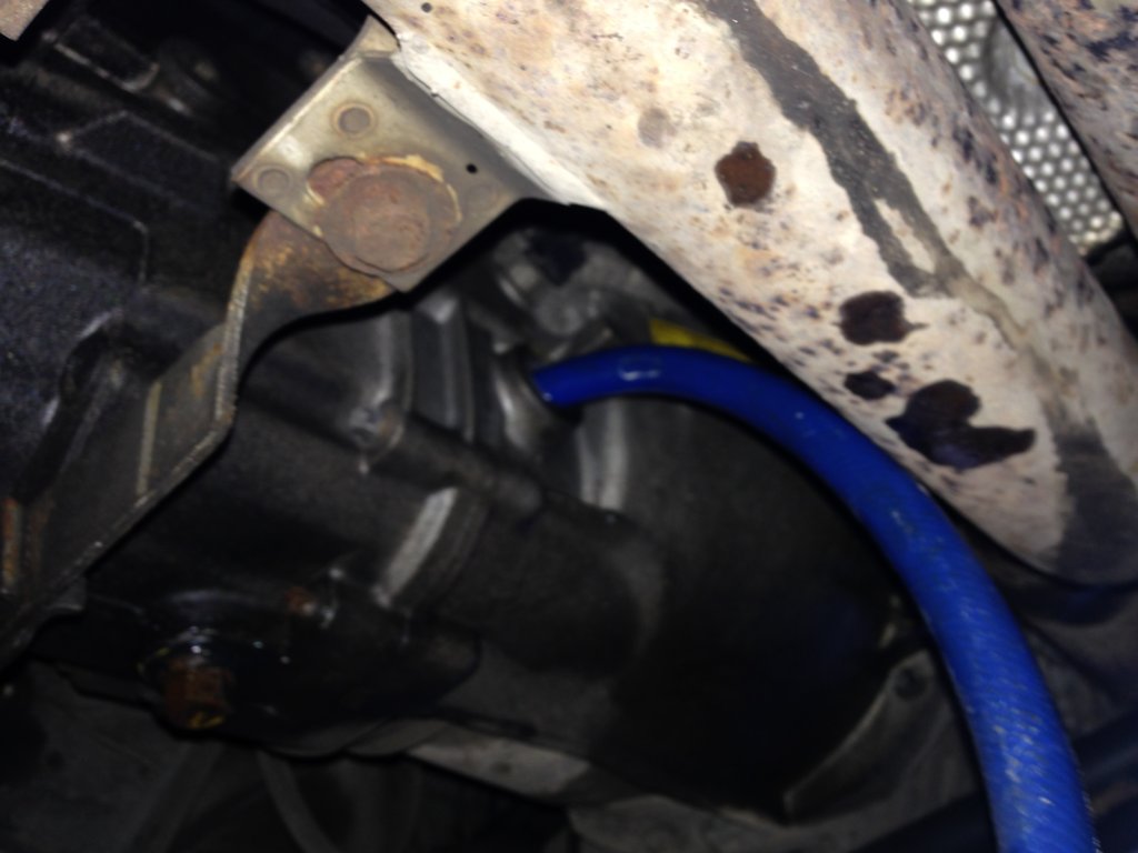

I had a very small amount of space to work with. I found a long inlet hose for washing machines came in handy.
The end fits in the refill hole quite nicely and can be wedged in. I swaged the other end so I could fit a large funnel inside. Then it was just a case of filling slowly and patiently.
I'll take it out tomorrow to see what difference it's made.
