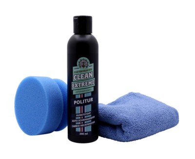

You can machine polish the rear window with the help and and able bodied assistant. Get them to hold a board wrapped in a towel on the inside of the rear window while you polish the outside, then swap places. I used this product on my Z3. There are several other products too.
Thank you Tony! ~ will look into these products and purchase accordingly.
