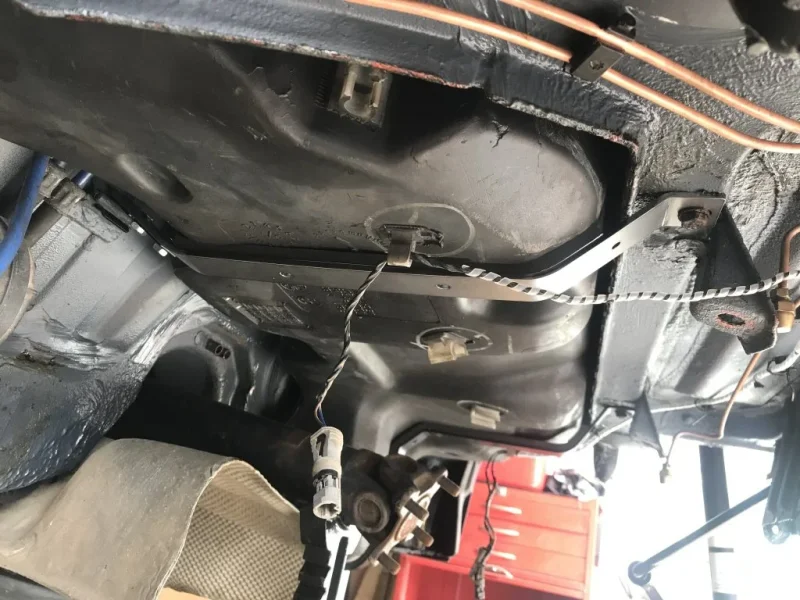

A step forward today …. Had a call to say first of the production batch of straps were done ( bent up that is) so went round to pick one of them up…
No studs in yet so just bolted them together
And look pretty good :thumbsup:
Pulled the axle unit out to get underneath and fitted them with some rubber cushion
Happy with that :):):)

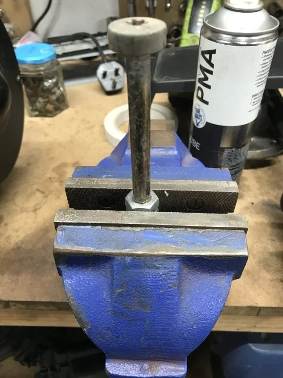

I did remove the two fixing bolts and noticed that one was slightly bent….
So found some nuts….
set it up in the vice…. As when its screwed up and down, you can identify which way the bend is….
Then is just a case of persuading it to be straight again….”:whistle:
:thumbsup:
