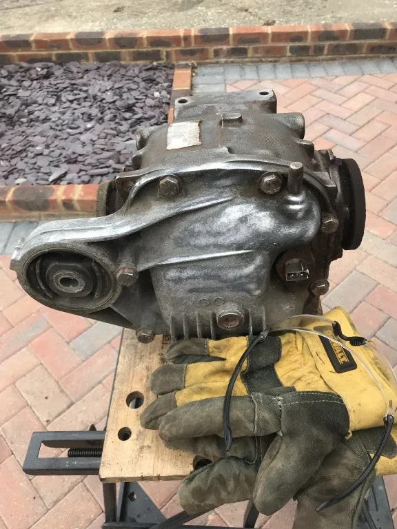

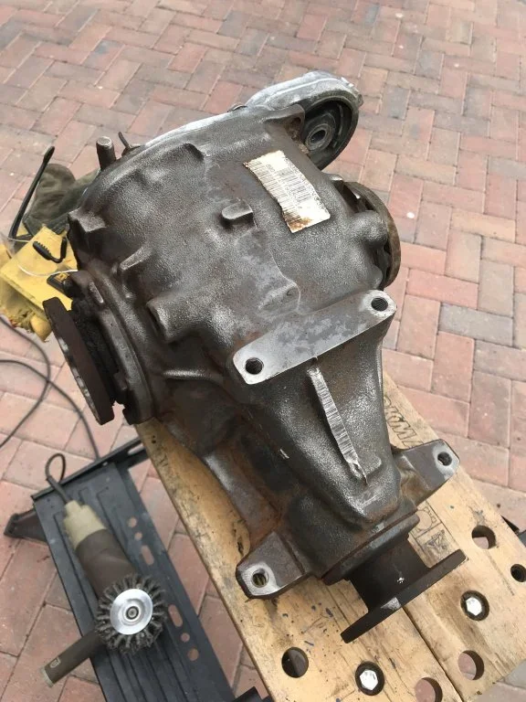

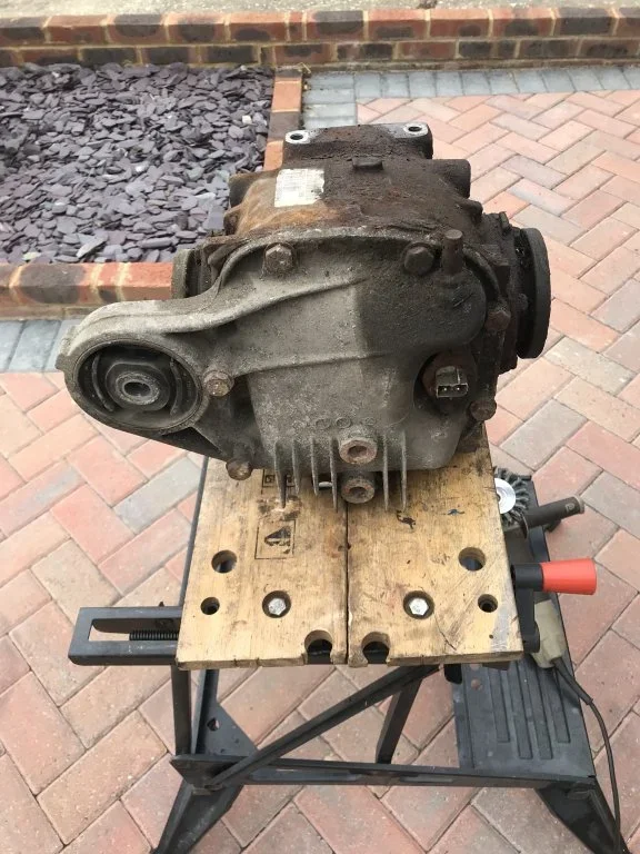

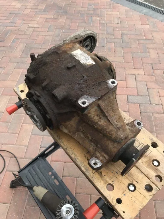

Then thought I see how well the spare diff would clean up…..
View attachment 267251View attachment 267253
Ten minutes the wire brush
View attachment 267255View attachment 267257

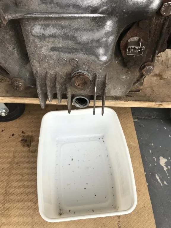

Thought I better drain the oil before turning it upside down….
Hmmmmm… thought there would be more than that
I think it was upside down in some photos when I bought it …. Must have already drained…. Saved me the job![]()
