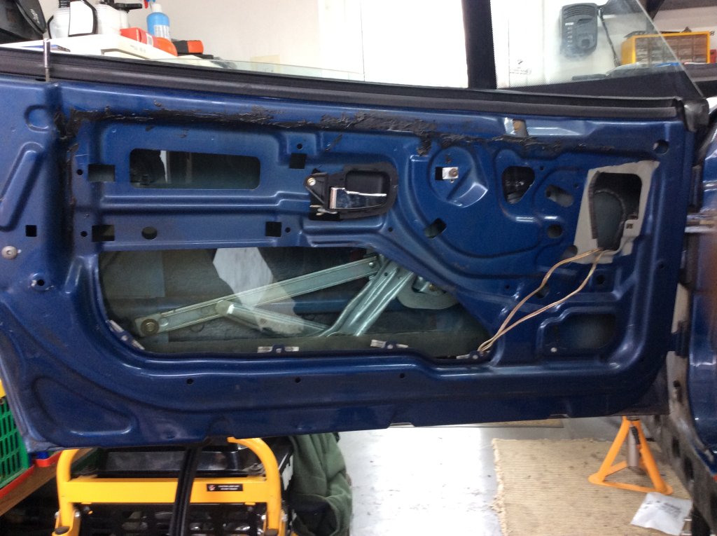

Took the drivers doorcard off to see what horrors awaited me…. And quite surprised…
Doorcard ok, no damage as such, and only the speaker grill to clean a spray black.
And only 4 of the fixing studs were broken…
:happy:
same amount of speaker wire plus a crossover unit. So labelled them and will reconnect it all and hope it all works
All the bottom white cable fixings ok , but the tape had disintegrated so the wiring was all loose.
The acoustic door sleeve was in good condition… and using a putty knife managed to cut through all the black gloop and remove it.
The other one is not too good, so will replace it.
Now these were off was able to disconnect the wing mirror wire and finally take the broken mirror off !!
Cant work out how to get the wiring off ????
It seems to be fixed both ends ???
One end has a 4way plug that is too big to go through the base…. The other end has the wires fixed to the motor unit !!!!
Confused now:whistle:
next job will be to clean all the residues of the black gloop off both doors…….oh what fun:eek:

The wires at the motor head terminate in miniature spade connectors Malc. Just pull them out with snipe nosed pliers ensuring you grip the actual metal connector and not the wire.
Oh and being a rock star and all that make sure you note where each wire went :D
Mazza
Nov 1, 2017
175
Bognor Regis
Thank you for the info..... and you’re right .....just plug in anything anywhere and wonder why theres no sound =)) =))

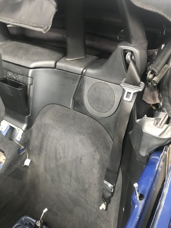

Stripped down the rear speaker covers and will do the same job as I will do on the door card grills. Also may be able to dremel off part of that ring to make them fit properly. Just need to check how much needs to come off.
took @Synclare ‘s advice…..
They all came out ok and now I know where to put them back =))

Started with sorting out the speaker grills.
New material bought and grills sprayed ( satin Black a la @t-tony ). And happy with the result
with a bit of dremmeling on the two rear ones ……Got them to fit over the speaker
so sorted out

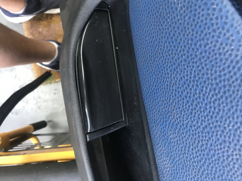

Next was a little issue with the ashtray light…
Part of the ashtray was missing, and the lid didn’t close… so I got a oddment box from Andy which replaces it….. but what to do about the light……
So after a bit of butchery on the ashtray
I had the part that holds the light bulb cut out
and after a bit of creativity… it will be fixed here

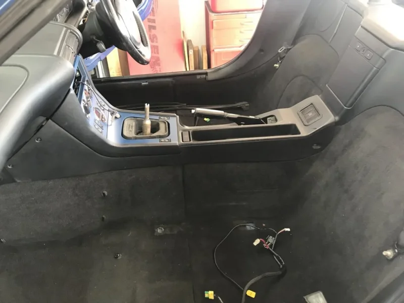

Also got the handbrake adjusted so should be able now to put the centre console back in ( next week !!)

It did take about an hour to put the parcel shelf liner in … but all sorted now…. And a bit further forward…..
Pull cords attached to make it easier
light pillar from ashtray glued in place..
all switches now sorted
Heated seat..ACS…. Clock…..roof…. Heated seat
( had to check the wiring diagram to see which was driver and which was passenger for the seat switches)
I did find the gear knob later and push that on as well.
Haven’t put the radio back until I have tried everything…. And cant do it just yet!!
