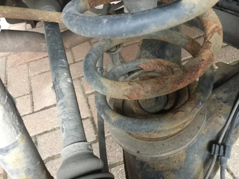

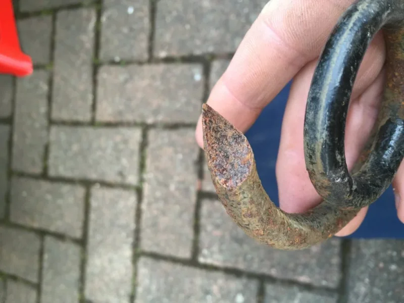

I took the back o/s rear wheel off and began cleaning up the hub face.
B.U.T. . . .
All stop as I spotted this....
So. guess what, the purchase of these spacers and dodgy wheels bolts have only gone and possibly saved my life. :p

What? You can't leave it like that Lex.
Now you wouldn't be a miserable mot tester and fail something as miniscule as that would you Tony!!!! :D

I've only fitted one so far as once I discovered the broken spring I obviously had to deal with that, so at the moment I have put one new lowering spring and shock on along with one spacer. Oh, and 5 zinc coated bolts :).
