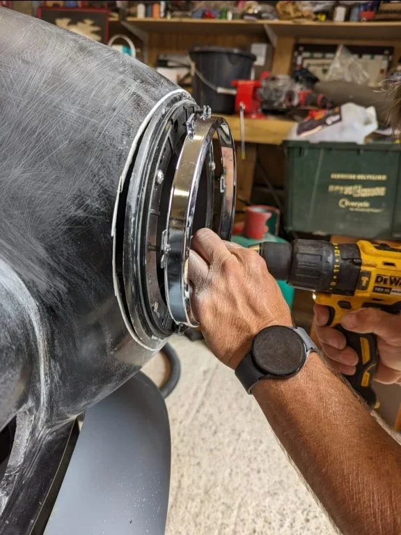

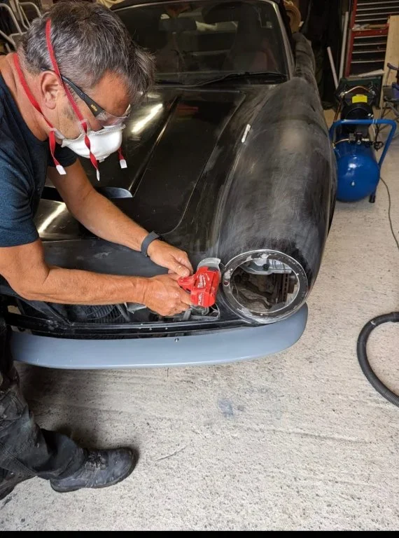

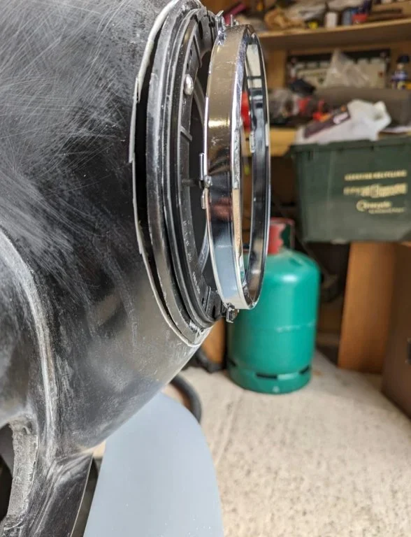

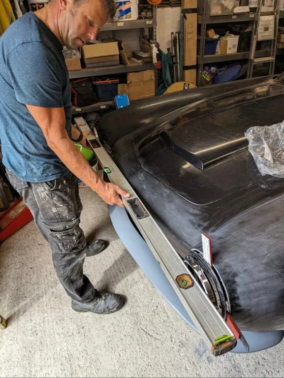

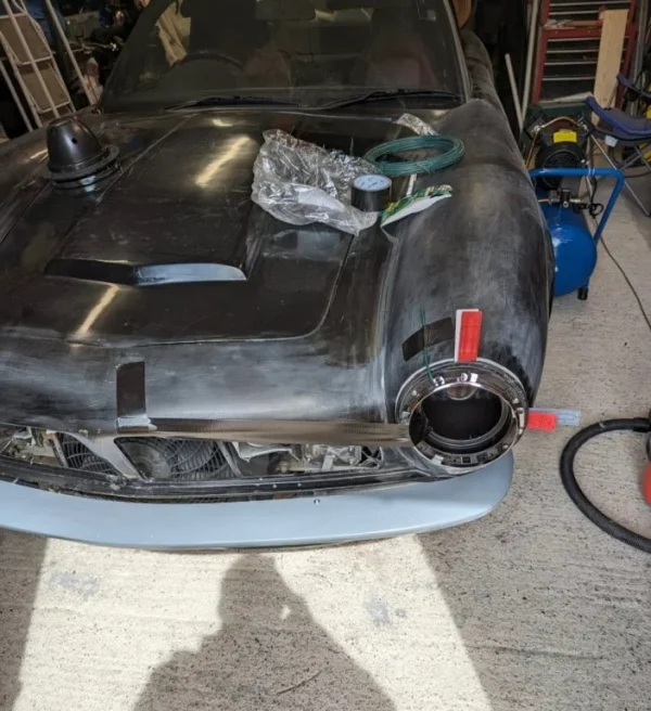

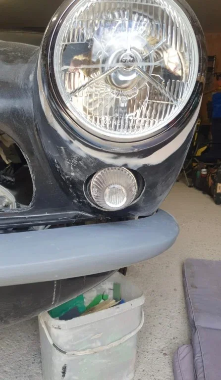

How was the mould for your headlight surround. My offside was fine but my near side was 15mm out of plumb, meaning that it was pointing upwards slightly. I ended up cutting 5mm back to retain the bezel and building the top out.

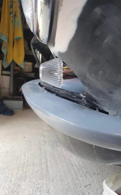

Had a nightmare with the karmann ghia indicators. Mine was the prototype so i think is a slightly different shape to Dans. When offering them up they pointed downwards. I've had recess them to get them looking straight.
My kit is just a week old and my nearside headlight is a bit wonkey too.
Top half of the headlight mounting surface looks straight but bottom half sticks out a bit.
I'll chop out that crescent shape you see from the underside and push the front surface back straight.
As for front indicators. I'm not going to bother with the VW slopey shaped ones. I'll either go for straight lucas style recessed. Or go full modern LED headlights with halo daytime driving lights and built in indicator.
Not decided yet. Might fit modern ones just to get it drivable while I make my mind up.
I've attached some pics.
I fitted the headlight bowl to make the cut section more stable, then used packers to get it right, then a bit of fiberglass filler dotted around to hold it in place, removed the packers, fibreglassed the inside and fibreglass filler on the outside.

You may want to fit some candle holders to the front as I see you have fitted the replica Lucas tribal lights. I did the same but the illumination from them ia truly awful, I had to use main beam continuously and never once got flashed, the illumination was still bad on main beam.
If you look inside the headlight you will notice that the bulb has a cap on it that is designed to reflect the light backwards onto the reflector and then project it forward, I think this is the source of the problem.
I had to swap my headlights for standard versions. I am intending to use stick on lead strips (sold to fit onto house windows), this should give a very similar look but not use the rearward reflector. I haven't got around to trying it yet but it should work, famous last words but the stick on lead is only a few pounds on eBay.

Thanks for the tip. Not planning on much evening driving but if I do I'm sure it'll move to the top of my list 😀

I’ve had no issues with the Tri-bar lights and night driving. I did use different bulbs to those supplied with the units as they didn’t look too clever.
I might upgrade to Osram Nightbreakers as I used them on other cars I have and are a superb upgrade for any light unit.
