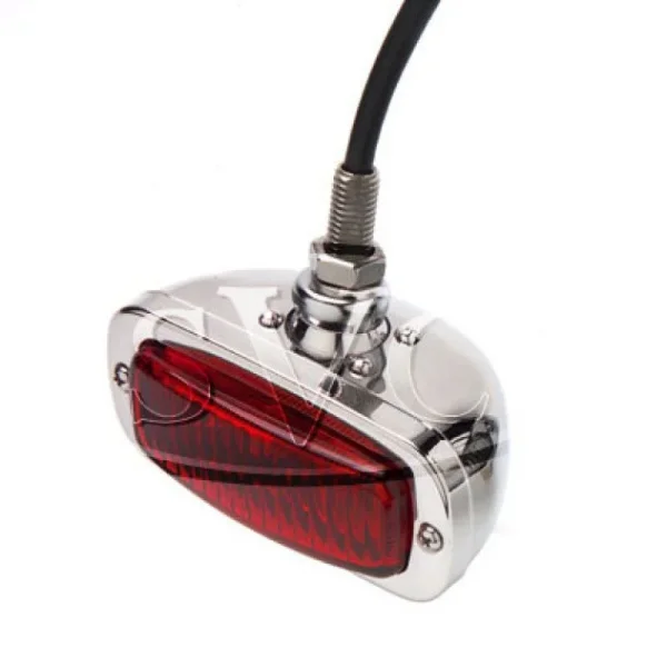

Your fog light looks like my one from a dsitance. Does it have the cable going through the hollow fixing 'bolt'? If so did you fill the hole with silicone sealant (or similar)?
Piran
Oct 21, 2022
41
Yes it does and no I didn't, funnily the fog light on the other side is fine.

I used this foglight. Hella part No. "‎2NE 002 985-001"and the matching reversing light. The lens has a little notch in the middle of the bottom edge that acts as a drain hole. I fitted mine upside down, same as you did so just needed to make sure that the notch went the other way - ie on the bottom.
Yours aren't the same as mine, then, as mine have no 'notch' in the lenses. Mine have a rubber gasket between the lens and the 'shroud'. Glass plain lens. The only way water can get into mine is either through the cable hole or possibly through where the adjustable 'knuckle joint' is. I have made some rubber washers up for the knuckle joint clamp. These are mine which are designed to 'hang down' which look (from a distance) the same

I think mine is coming through the knuckle.
